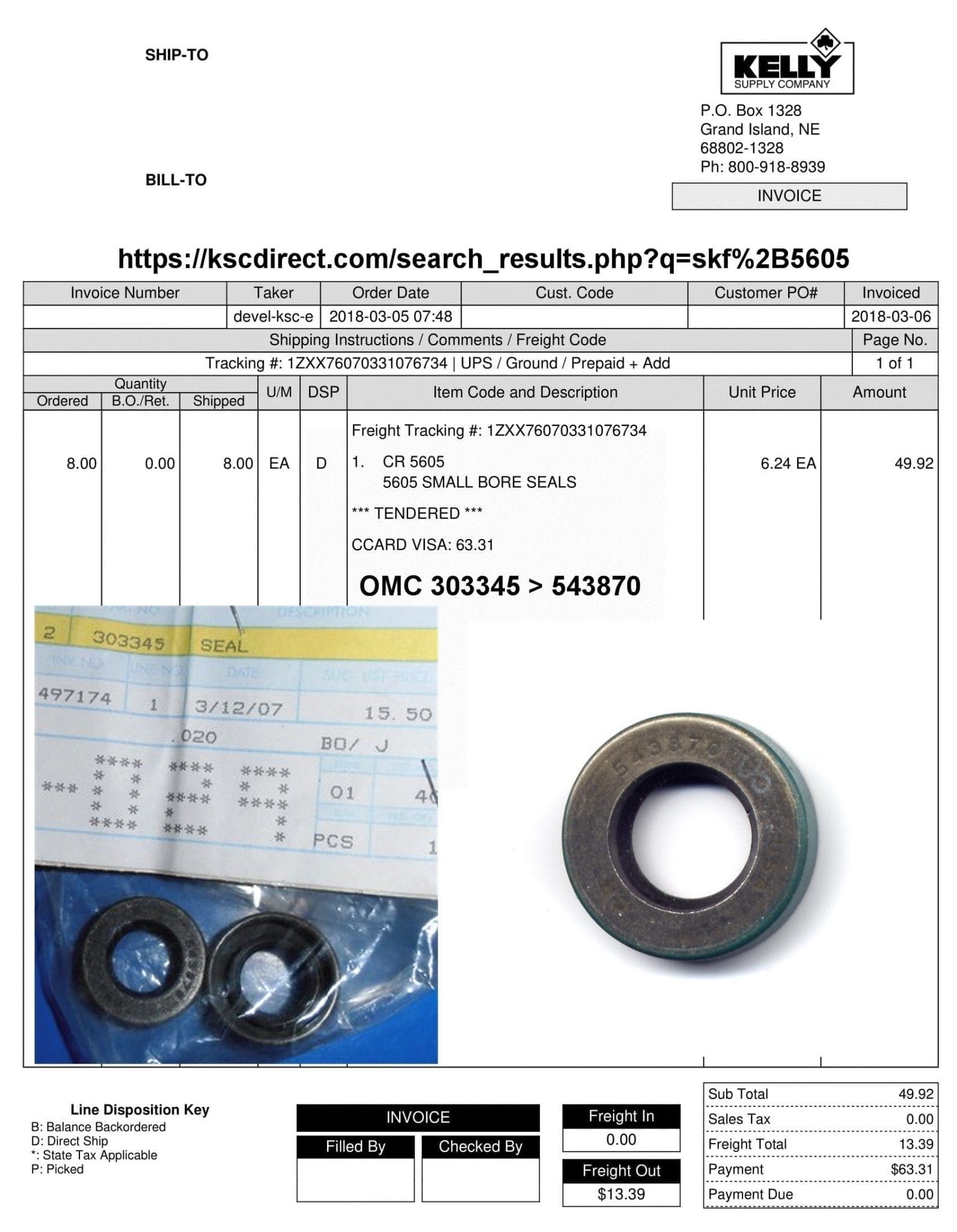

            Hey Jacques, I’ve been able to find that seal sometimes under CR/SKF 5605 at a much lower price. You could check bearing/seal houses in your area or NAPA, RockAuto, Advantage Auto, Kelly, etc. or whatever else you might have out there. I have gone to NAPA and ordered them and it might take 5-7 days for them to get them in and sometimes a minimal shipping charge but it works out to be a fairly reasonable price.
            KSC-Supply-SKF-5605-seals-303345-to-543870-1

              The number crosses to SKF 5605 (SKF is the old Chicago Rawhide that made the OEM seals).
              http://www.skfextranet.com/Catalogs/457010/sealdetail.asp?s=5605
              https://www.skf.com/group/products/seals/industrial-seals/power-transmission-seals/radial-shaft-seals-pt/index.html?designation=5605
              With this number, you can search the web for a good price, or go to your local bearing store if you have one nearby.
