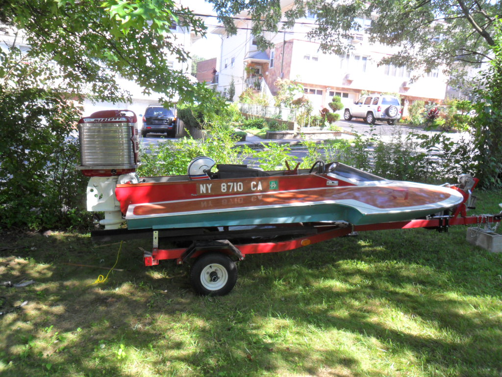

May 13, 2017 at 11:50 pm #57666This is a Merc 200 (22 ci) on a KE7 tower and a KG7 foot. The KE tower allows about 3/8" more engagement, driveshaft to crankshaft. KG will work but might strip. On an 8′ runabout. Works great.
