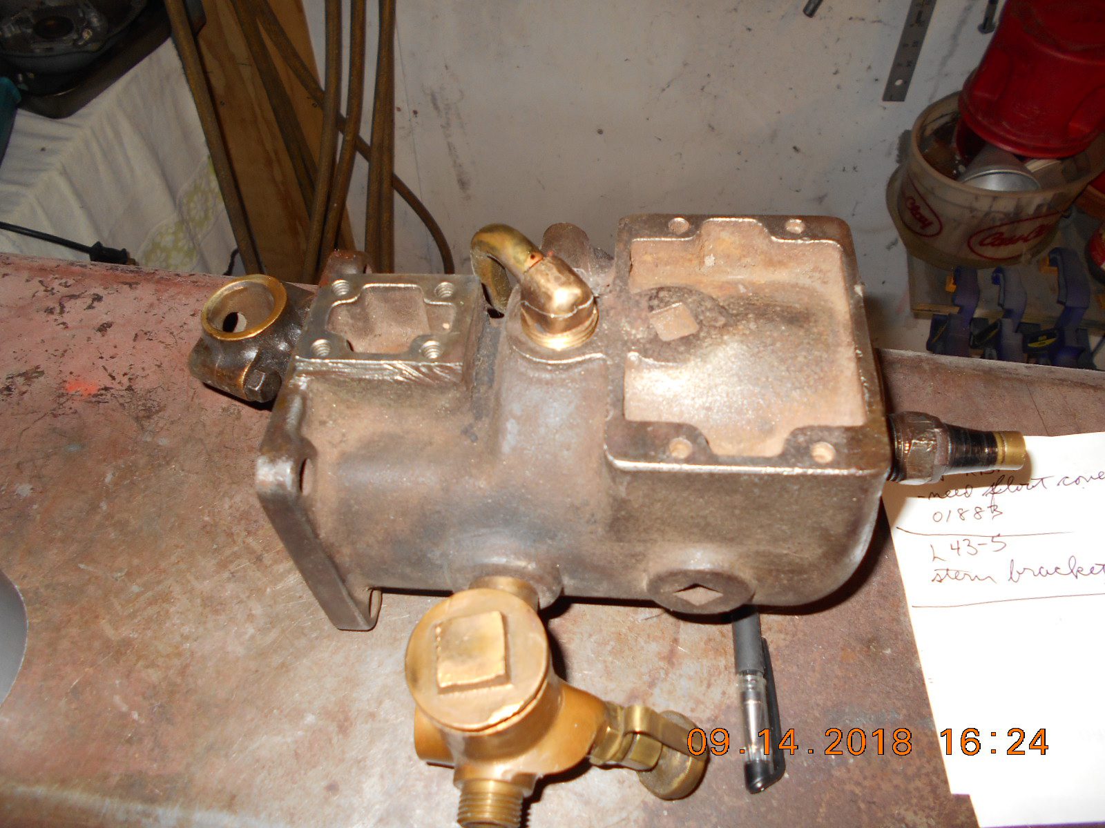

      I’m not sure if the poppet valve guide can be “bushed”, as there’s
      not much meat in the casting. But in order to even try, I’d have to
      be able to get the carb out of the cylinder.
      I was not able to get it to budge when I was refurbishing the motor.
      It was not designed with a “flat” to put a wrench on it, the castings
      are delicate, and there’s not even a good place for a pipe wrench
      with padding to grab a hold.
      I presume the carb unscrews, and not just pushed into a hole with
      sealer, but either way, it’s probably has never been out in the last
      100 plus years.

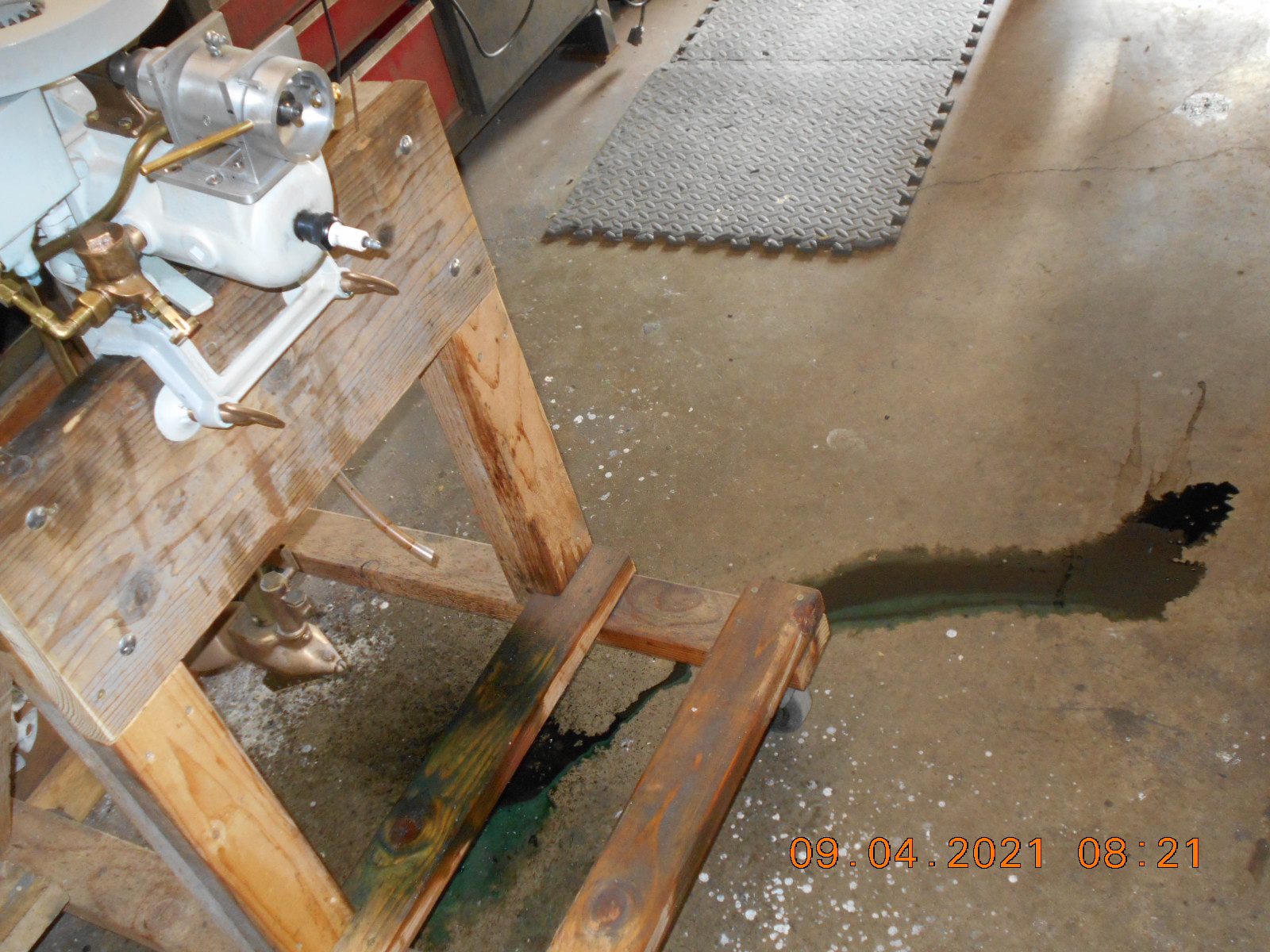

                      When I went out to the garage yesterday morning, I found out I had
                      a “senior moment” the day before, and left the fuel supply valve “on”
                      overnight, and had a big puddle of gas on the floor, gas dripping out
                      of the muffler, cylinder and crankcase as well.
                      I have the motor half apart, drying it out, so decided it was a good time
                      to address the poppet valve. Perhaps the old sloppy valve wasn’t seating
                      too good, but when I lapped it in with valve grinding compound originally,
                      it looked okay.
                      Thanks!

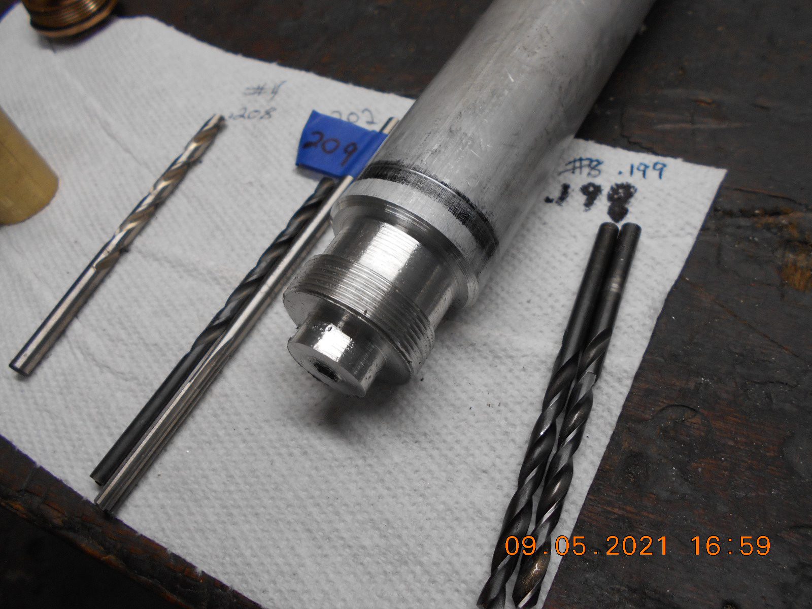

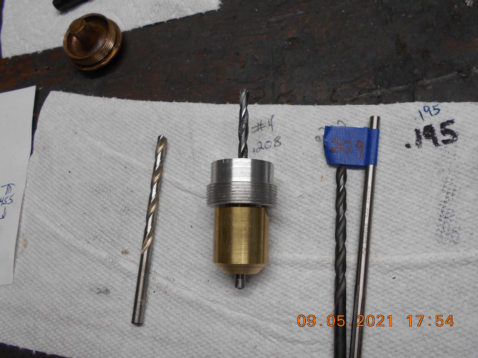

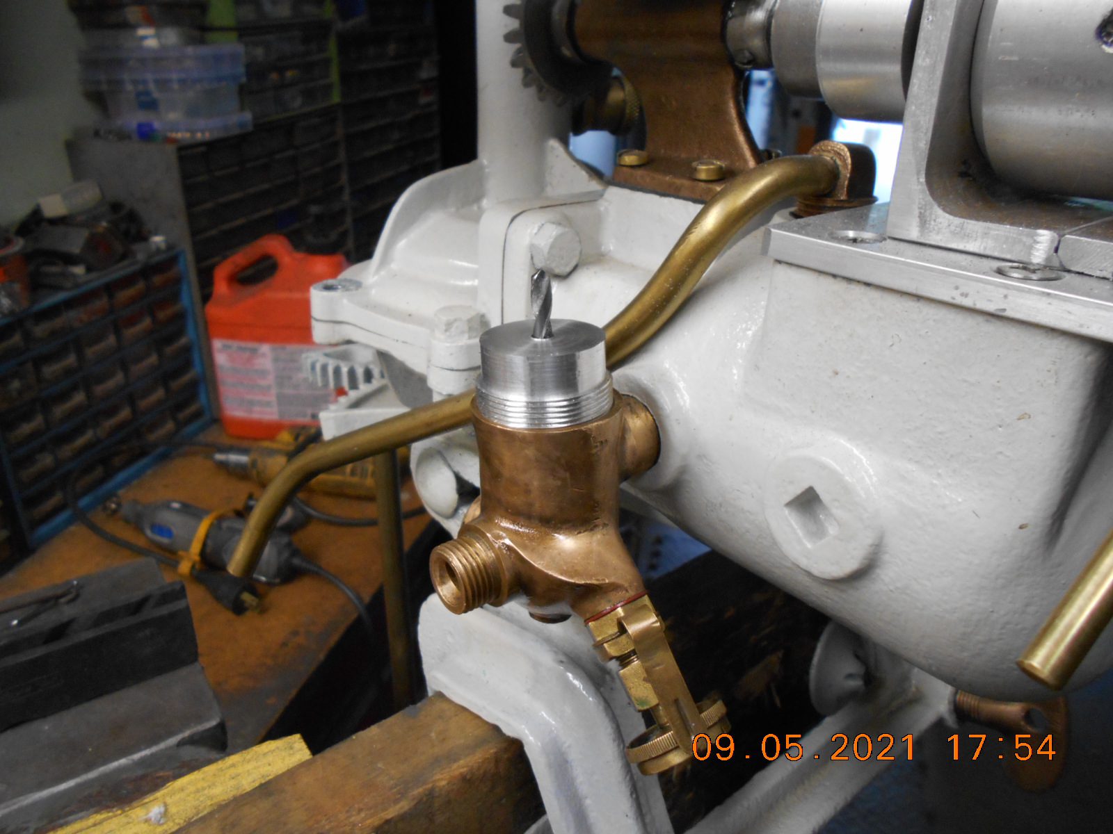

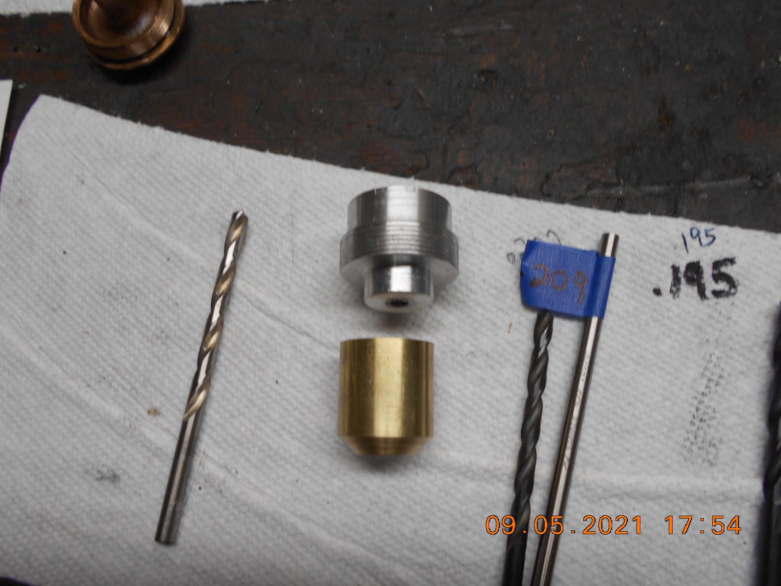

                        I decided to take the more logical step first, and machine a guide for drilling and reaming
                        out the worn poppet valve guide, then start on the poppet valve, as I found
                        a reamer that should work.
                        The old guide hole was worn out to almost .200, and the valve stem is .185 if I remember
                        correctly. I have a .202 drill bit, and a .209 reamer.
                        To date, I’ve had very little experience with little reamers.
                        Will a little reamer remove .007 of bronze material okay using
                        a tap holder, turning by hand?
                        Not sure there’s room for a drill,
                        but perhaps using one would end up with a better bore?
                        Anyway, I ended up making a two part guide. I kind of “winged” it,
                        but after the fact, I was thinking I probably could have made it one piece.
                        I think it will work okay as is though.
                        Will ream it out tomorrow, and hopefully start on the new poppet valve.
                        Not sure I’ll solve any running issue with the motor, but at least
                        I’m getting some machining practice!
