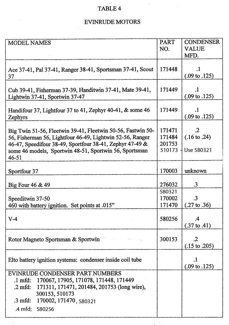

      Anyone know the part number for the capacitor used in this motor. Trying to help a member but my Merc o tronic book only shows part numbers for the cap. I need the part number to referance it to help our member. Thank you in advance.
      Jeff
      #36347
        Two different P/N’s and uF ratings for the Zephyr caps. Depends if the motor is an early or post war one. I’m pretty sure the early ones had removable heels on the ends of the coils.
        #36443
        jeff-register
          Jim,
          Thank you so much. We have a happy customer tonight.
