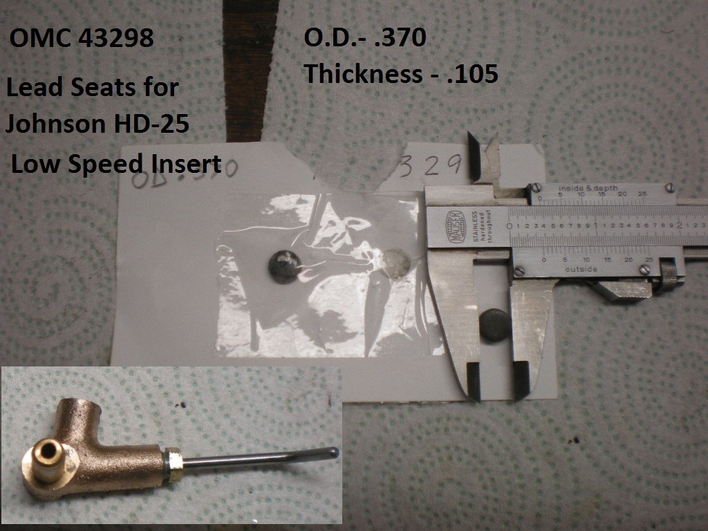

Garry, I believe I have the same information in the manual, but
glad I reviewed yours, as I don’t remember reading that
when you drive in a new insert with a lead seat installed,
you’re suppose to drill out the lead seat with a 5/32"
bit.
Makes me wonder if the new lead seat doesn’t
have a hole, or it does, but it needs reamed out
after being "squashed"?
