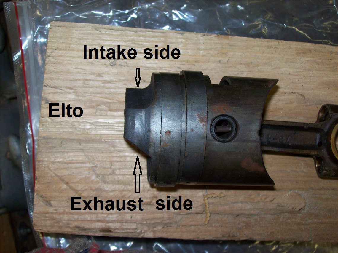

                  HARRY D. NICHOLSON
                    When you remove spark plugs, you should see the intake side of the piston.
                    EltoRuddertwinPiston003
                    I think your battery is at fault.  One member uses a bunch of D flashlight batteries hooked together for the right voltage and capacity.  Amps are needed and not just voltage.
