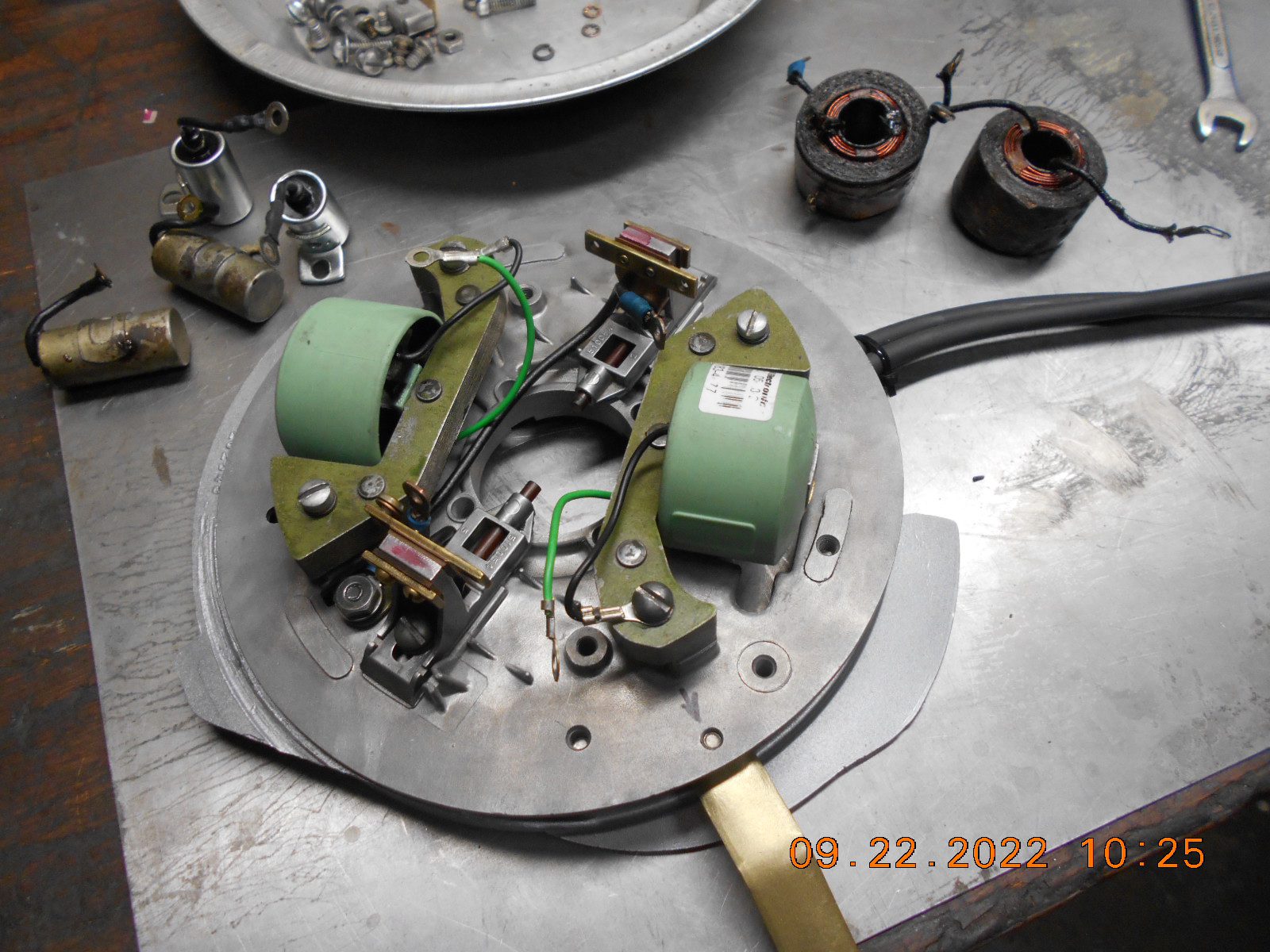

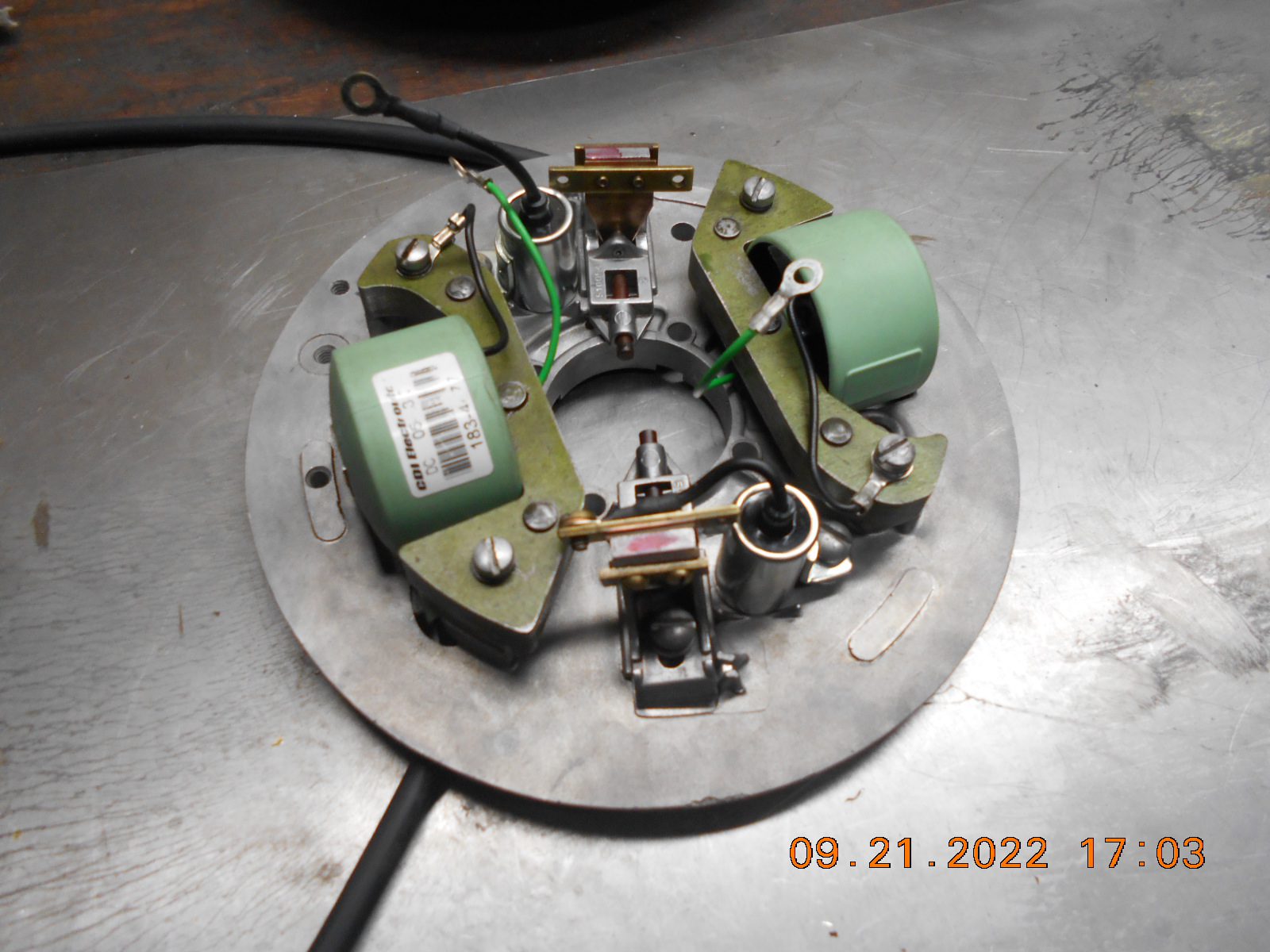

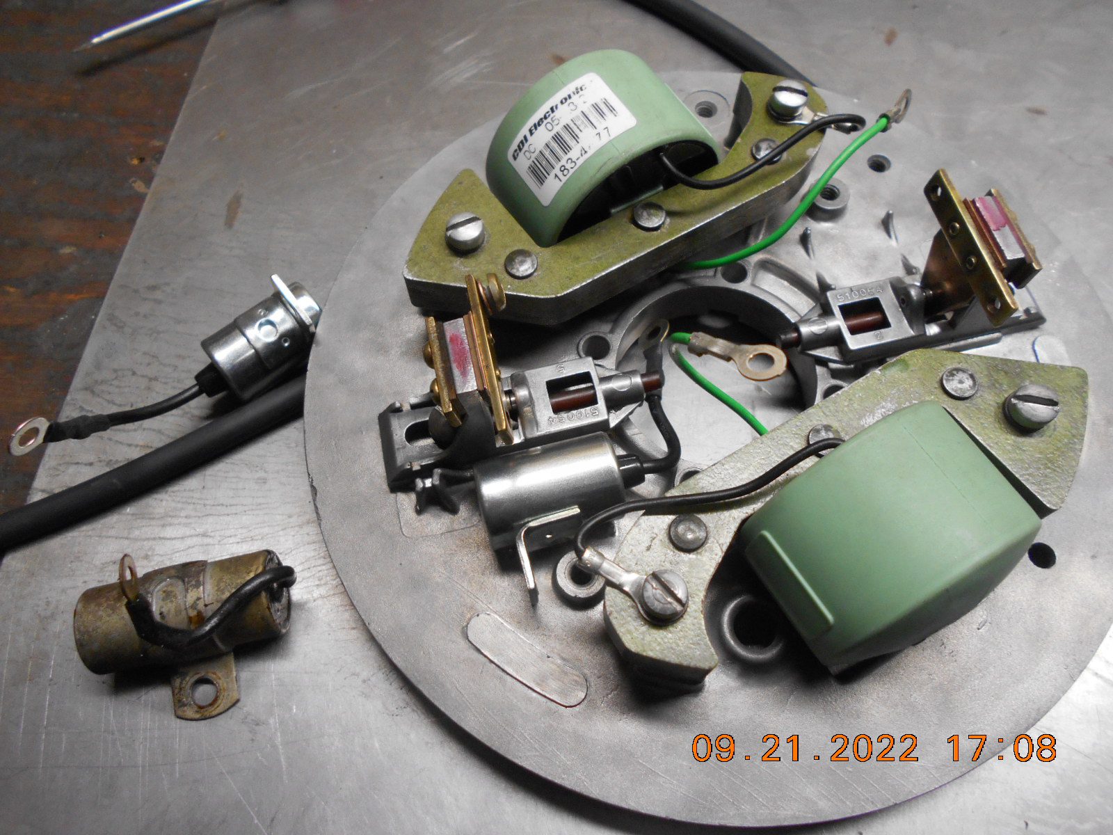

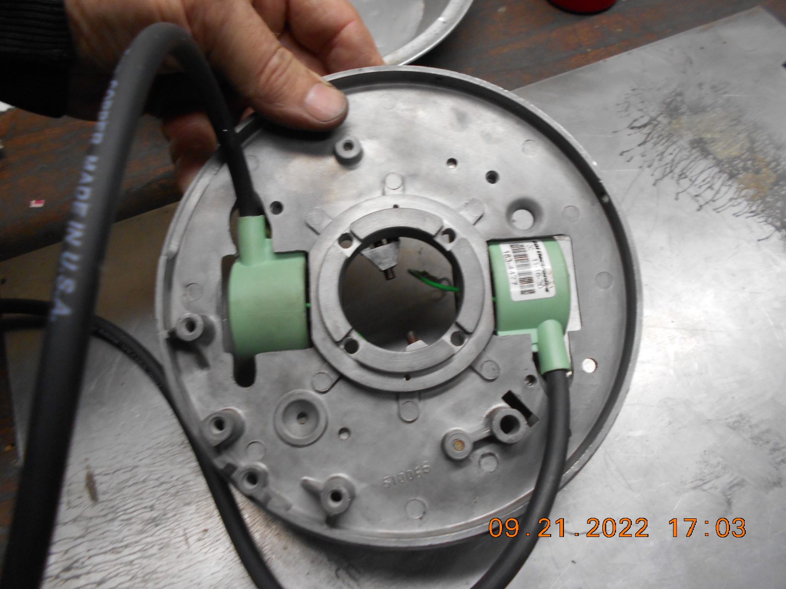

            Progress made on the coil swap today.
            A little nervous cutting away precious metal on the mag plate,
            near one coil bolt mount area on each coil, but I think all
            will be A-okay..
            I thought I may be able to use vertical universal condensers
            to replace the old horizontally mounted ones, but even
            though the height of the condensers wasn’t an issue,
            the vertical condensers interfered with the point adjustment
            travel.
            I “may” try some careful surgery and swap the mount brackets
            between the old and new condensers, and if that don’t work,
            I may try a retrofit with axial capacitors.
            I need to find some condensers with the removable mount bracket
            for such occasions!

                  Wow!  That looks beautiful Buc!  I am experimenting with the Ceramic style caps now as well as the axial.  The ceramics sure are tiny!  But….whatever you end up doing I’m sure it will work out fine and look beautiful!

                    I may try a retrofit with axial capacitors……
                    those small ceramic condensers in mr. Mohat’s   article should do fine . space wise      you could  cut down some old  caps  by 50%  to shrink them down  and stick the ceramics inside

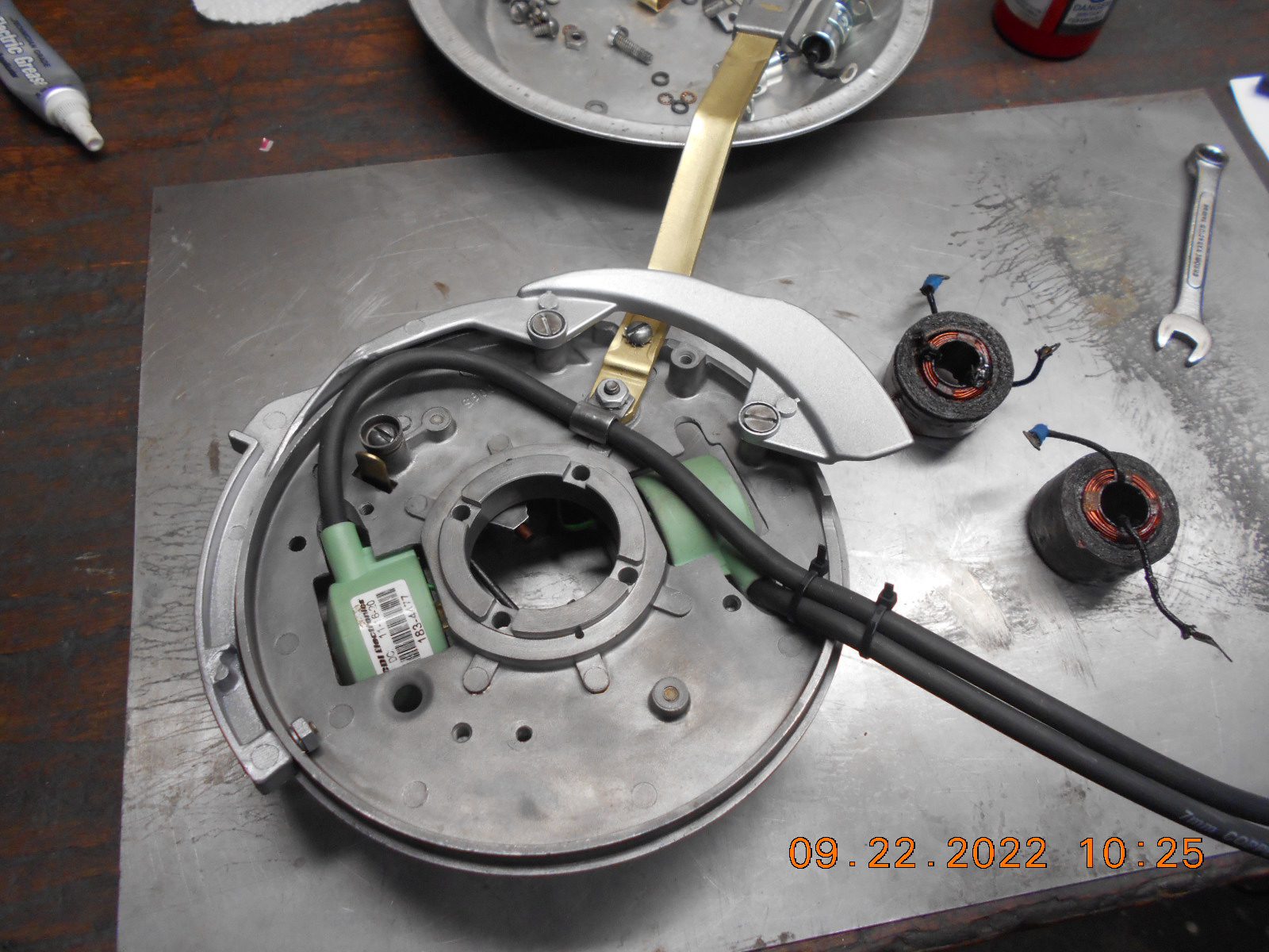

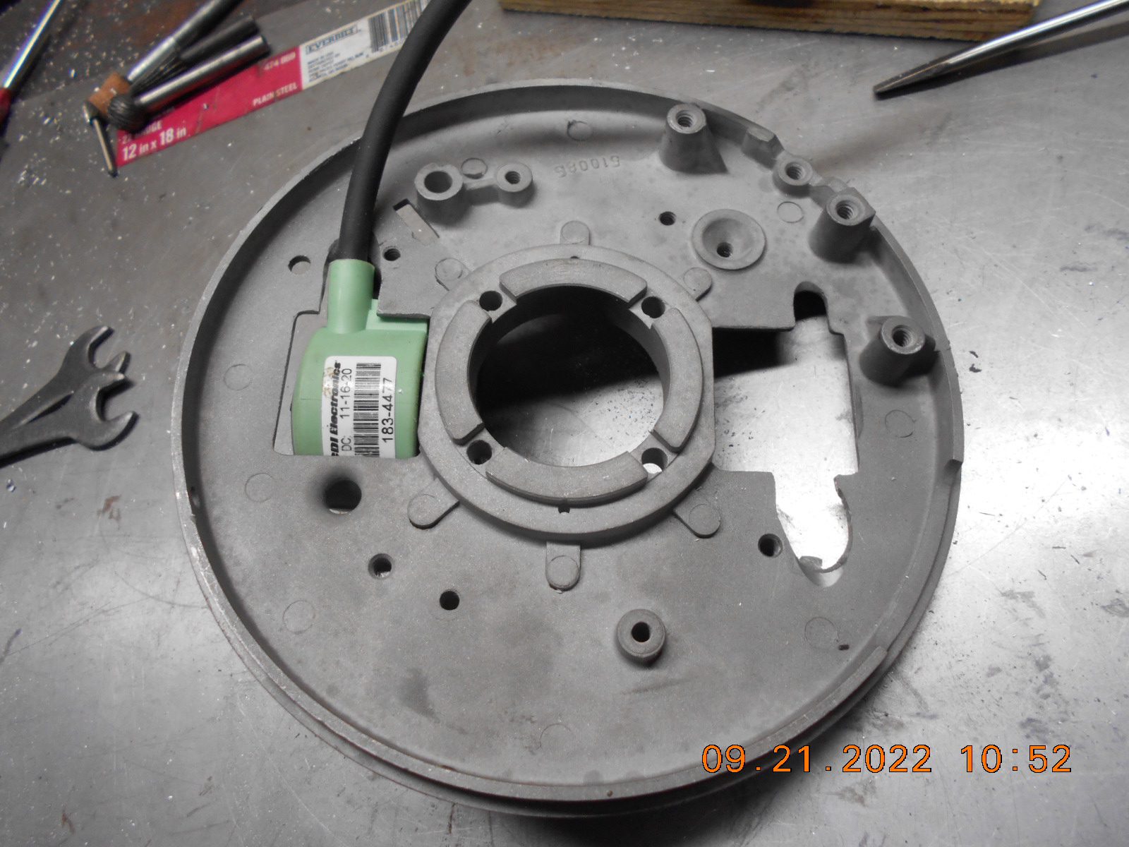

                        More work on the magneto today.
                        The bottom cylinder’s coil plug wire circles
                        around the opposite direction as with the original
                        coils, but I didn’t seen any issues when I mounted
                        the mag on the power head.
                        DSCN4823
                        I have not put the flywheel on yet, but hoping to have no issues
                        with the new coils rubbing.
                        DSCN4824

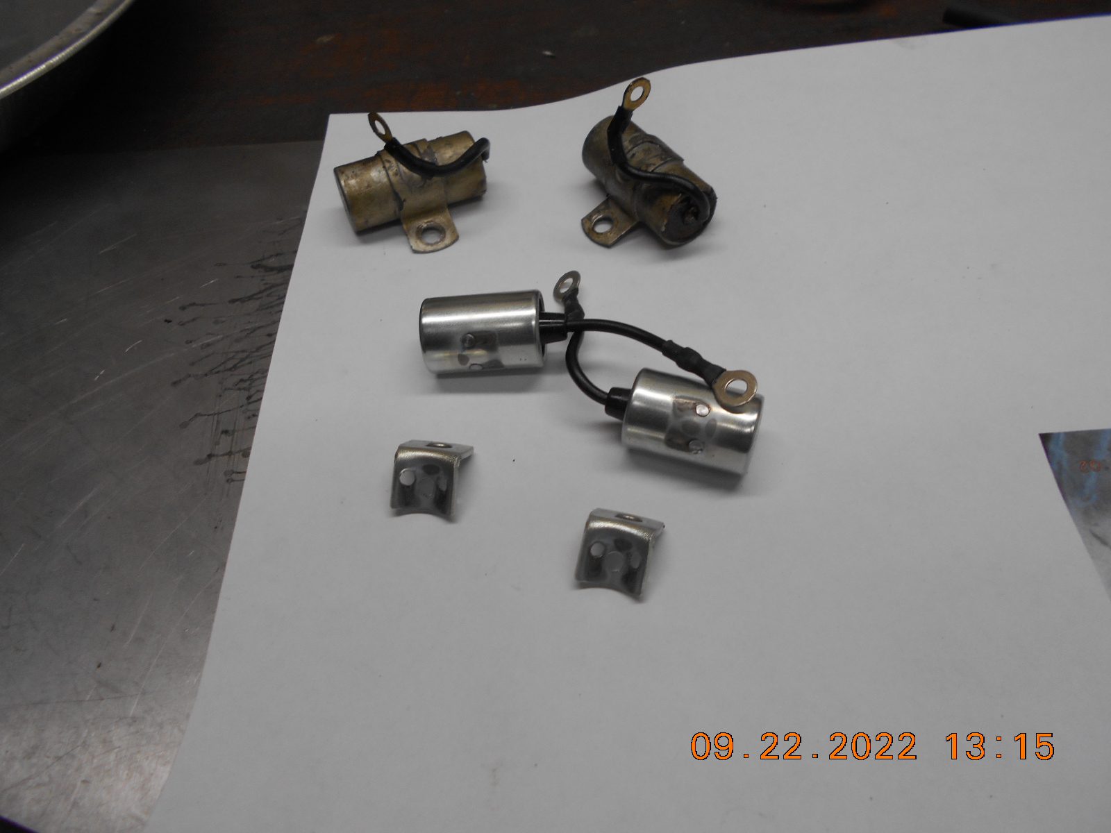

                        I decided to alter some $7 universal magneto type condensers
                        with brackets from the old style condensers.
                        The new condenser’s brackets were attached to their cans
                        with two tiny spot welds.
                        I “carefully” drilled the spot welds away on the milling machine
                        using an 1/8″ end mill.
                        I measured the bracket thickness, and used the mill DRO so
                        I didn’t drill too deep!
                        They’re installed on the mag plate, and appear that they “‘should work” okay.
