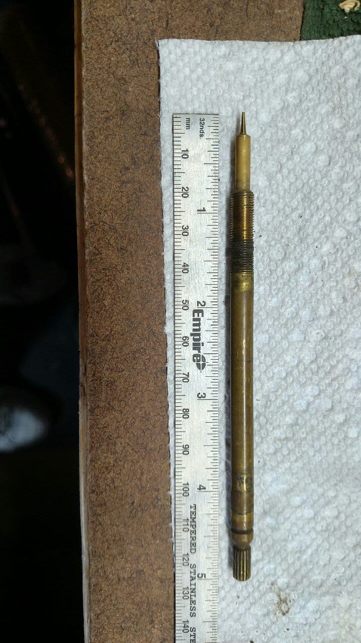

            To Fleetwin My needle does not appear broken and is without rings or mars on the taper, but it appears somewhat blunt. I don’t have a similar carb needle to compare it to, so I don’t really know if it is perfect, but the engine runs.
            #225092
              OK, will try to post a picture of a good 6hp needle in the future….D
              #225096
                While the wrong needle would certainly be a big problem, you’d think that a blunt needle would run with FEWER turns out from lightly seated…..?
                #225120
                  This is out of a six.
                  6-hp-needle-valve
                  #225169
                  Tom Bertulli
                    Hi Billw, Looks about right in dimensions but mine is more rounded at the point and shows less of a flat tip. Probably does not mean much? Thanks for the photo.
