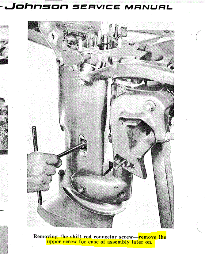

        You could always remove the other bolt from the shift rod connector
        and see if it drops then.
        #324143
          RD-SHIFT-release
          RD-SHIFT-release
          that is what  the book says… upper bolt needs to come out !!
          #324148
            I really don’t believe that shift rod connector is causing the issue, but anything is possible.  Like others have said, remove the other bolt also and see if that helps.
            I’m hoping the driveshaft is not stuck into the crankshaft…
            How many bolts hold this gearcase in place?  5 or 7?  There is the one through bolt towards the rear, was that a bolt that you removed, or a stud with a nut on it?  If it is a stud, salt may have built up around the stud jamming it into the exhaust housing, preventing you from removing the gearcase.
              I removed 6 bolts. Along the bottom of the bullet. I removed the bottom bolt in the brass coupler (everything I read said don’t remove the top one – but I trust the manual obviously you’ve shown me).
              I have NOT removed that bolt in the rear (shown in the photo). Is that required to come out?

              #324174
                Yes remove the larger bolt also.
                #324177
                RESOLVED:
                The lower came off easy with that big bolt at the rear. Very simple!
