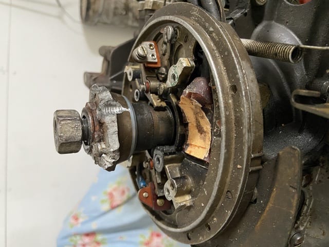

            Has anyone seen anything like this? This flywheel would not budge. Then it started to move but for all the wrong reasons.
            9C010730-E036-4A58-BBCE-AB396E28F152

              Dang! That’s what usually happens when a three jaw puller is used to remove the flywheel. Using a three jaw on the outside edge of a flywheel is a big no no. The three threaded holes on top of the flywheel, where this one is broken, are used to remove a flywheel. Now you still have to get the core off the crankshaft.
              #228024
              Boonie
                Guess I should have started at the big inning. Bought this motor from a guy that said it was to big for him to work on. He said it had spark on one cylinder. So I proceeded to remove the flywheel. One of the three bolt holes on the flywheel had been drilled and taped to 5/16. (Should have been my first clue). So I proceeded to set up my harmonic balancer to do the pull. One of the 1/4 20 holes let loose. Taped that one bigger and tried again. Little bit of force and the flywheel started to lift from one side. Cracked. I do use the proper tool. I have seen tight flywheels before but never like this one. Is it possible that the key has shifted. I’m thinking the only way now is to sergically remove it.

                  Used a harmonic balancer. Pulled from the proper position.

                    Back in the day we had a 1953 Evinrude 25. The long coil screw came loose and made the throttle plate stick at times.
                    My dad was a perfectionised kinda guy.He put on the proper OMC puller tightened all bolts equal and rapped the top of the puller with a hammer no go. My dad stripped the 1/4 and retapped 5/16 bolts finally it came off with a bang with 3/8 bolts in the puller.We could never figure out why that motor was so tight there was no rust on the flywheel.I have pulled lots of rusty ones with ease.

                      I’m not quite sure how to proceed next. Can’t get a puller on it now. Try and relieve it with a die grinder?
                      #228070
                        Sounds like your 20 minute job just became a 3 day project!
