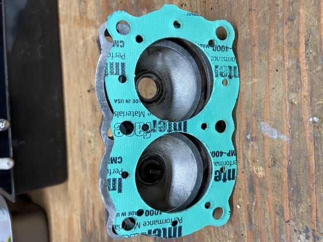

      Replacing the head gasket on my lightwin 3 hp. Do I need to use sealant? Or install dry?
      #227897
      Boonie
        I have never used gasket material like this before. Also what is the torque for the head bolts?

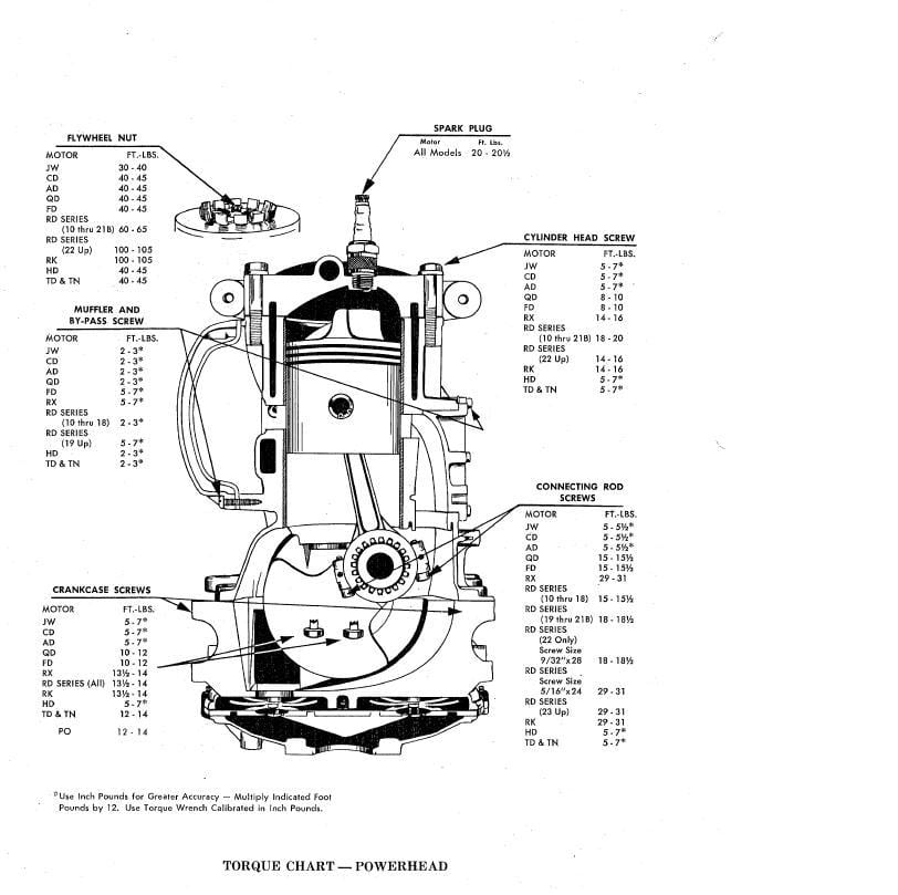

          I typically install my head gaskets dry, but some folks use a sealer around the water passage only, not on the cylinder surfaces. Here’s a torque chart.

            These small heads tend to warp over time allowing the head gasket to blow between the two cylinders. While it is off is a good time to lap it flat again using 220 wet n dry on as hard, flat surface. A piece of plate glass works perfect for this.

              I would not use sealer only on the water jacket. that would make the cyl and head looser fit and make it blow easier. just my opinion.

                Probably should have outlined my response a little better. I’ve read where some folks would apply sealer to the water jackets only. I agree that may not be the best approach, and I’ve always just installed mine dry. Never had an issue doing this. Some new head gaskets are marked “Use no Sealer” but I also know some OMC manuals also indicated to always use a sealer I’ll defer to those with far more experience than me.
