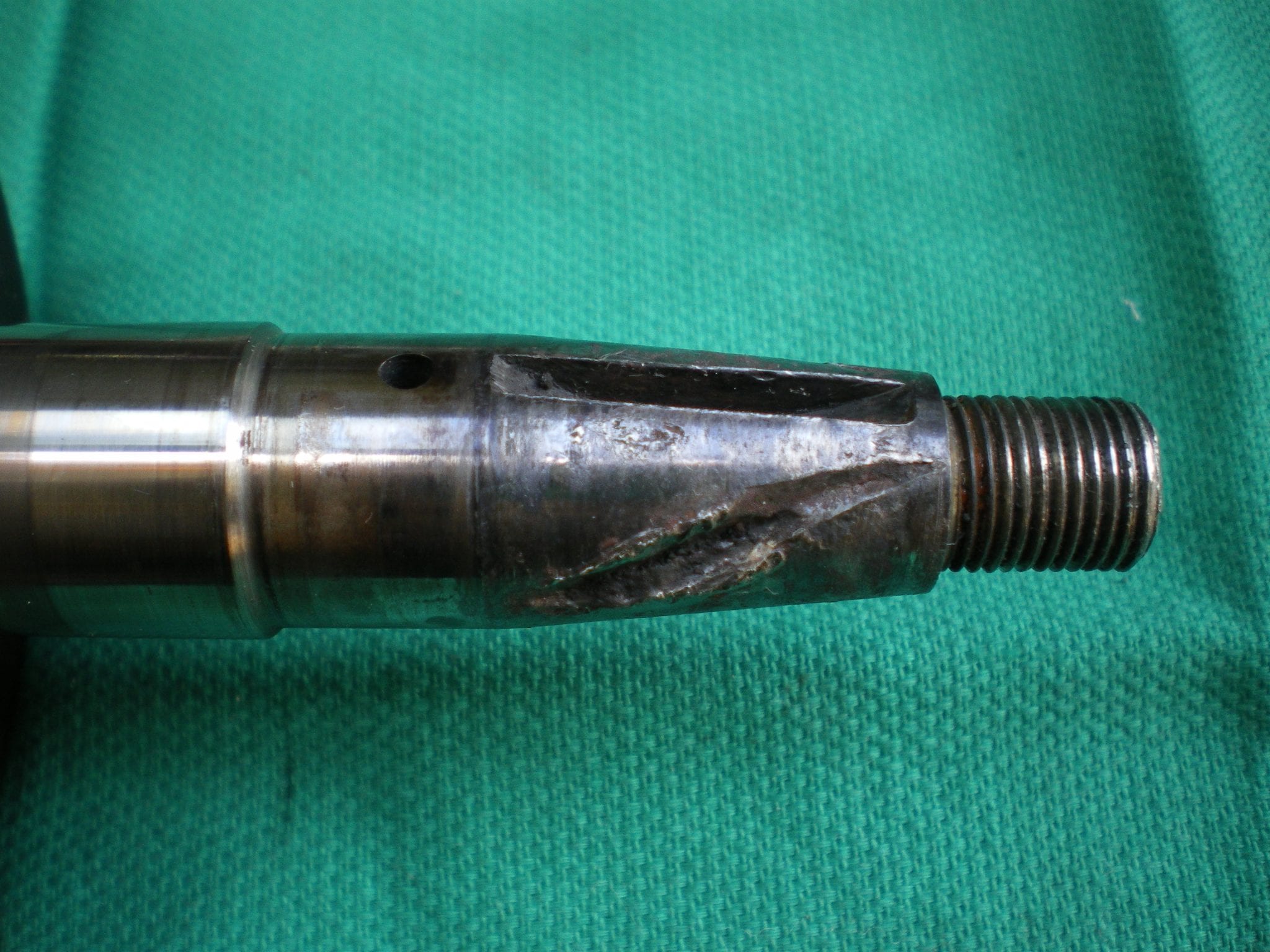

      If the hub is steel and you decide to burn it off, be really careful you don’t damage the crank.

      #228133
      JOHN HOLBIK
        Cut in towards the crank with a thin cutoff disc on a mini grinder .Stop before you get to the crank then split it with a chisel.
        #228157
        Boonie
          That’s what I thought as well. I will line up with the key way. That way if I cut to deep I can replace the key.
          #228348
          JOHN HOLBIK
            Good Idea.
            #228349
            JOHN HOLBIK
              If you cut two slots fairly close to each other you can break the piece off with a hammer and punch then a couple hits with the chisel.

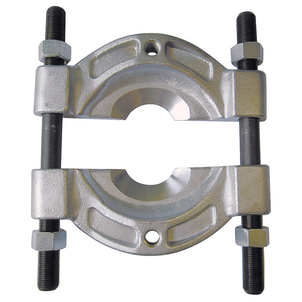

                  #228382
                    It will come off off using a guillotine bearing puller teamed up with a harmonic balancer puller..

                    #228412
                    Boonie
                      Thanks. I think I’ll try mumbles idea first with a bit of heat. Just need to wait for amizon to deliver my guillotine puller. Another tool for the tool box!
