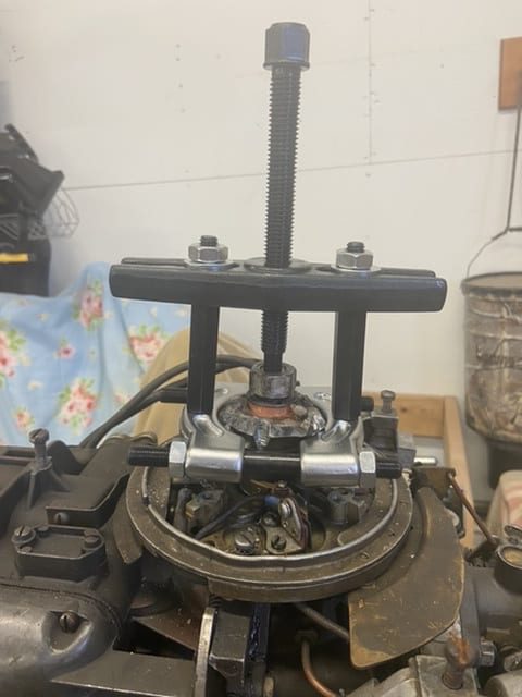

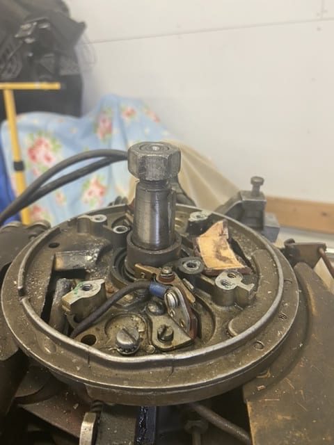

      Ok so here we go. Tightened this puller up and gave it two moderate blows with my hammer. Before and after pictures.
      611BA16A-050A-4D7D-8E0D-845494438ED1
      1EE178FE-58E9-45EB-BF9E-030E86152F62
      • This reply was modified 5 years, 1 month ago by Mumbles.
      #228574
      Boonie
        Mumbles nailed it! No damage to the crank.
        Now I need to find a new flywheel.
        RD 10 part # 580-109. If anybody has a lead I would appreciate it.
