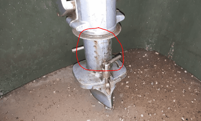

          Next challenge will e the cooling system. Gather this is where the water should be exiting? It isn’t!
          Impeller looked good.
          Water_outlet

          #196163
            looks isn’t a reliable test …. change the impeller !

            Elecmuso
              I’ve been looking at a ot of youtube videos and none of them show much on the way of water coming out of those holes. Perhaps it is ‘normal’ and I should look for even a small flow (I’ll only run it for a minima time). Is there a way to tell if the engine is staying cool without actually observing a particular rate of water exiting the exhaust? Are these typical of ‘normal flow’?

              lindy46
                You won’t see a lot of water coming out – only a “mist” or “weeping”. Those little engines run a little on the hot side. You can check the block while running. Splash a little water on it. It shouldn’t boil off. Temp should be 145-160 degrees. I agree, always put in a new impeller on a new-to-you motor.

                  You will see only droplets of water which just happen to blow out by the exhaust. The flat plate on the side of the powerhead gets blazingly hot. There is fire on the other side of that plate. They also get pretty hot right around the spark plugs, but further out should be cooler.

                      Elecmuso
                        So I had another look and that 2nd video above is pretty much exactly what I get – so I guess it is in fact running normally.
