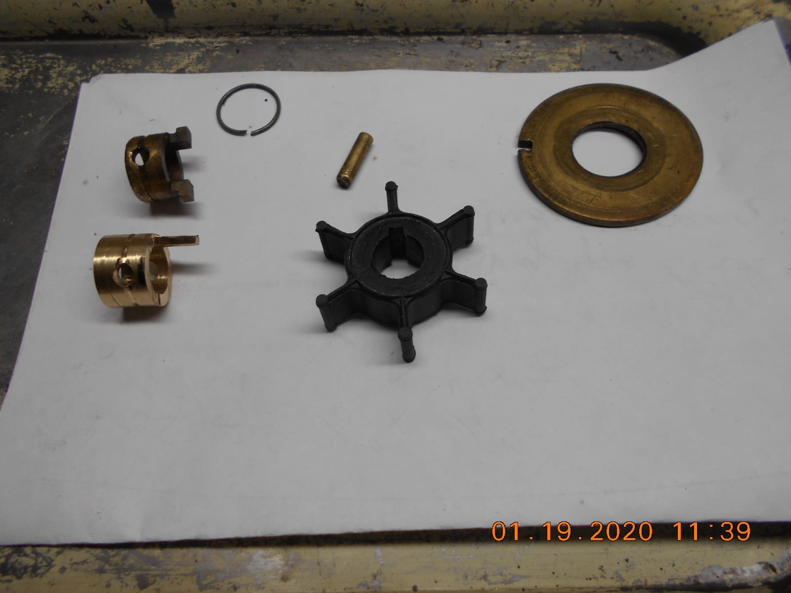

                I read that article, and thought about doing the same on my KD4, melting the
                slots in the new impeller, but when I held up the drive piece, the lugs just
                about went across the whole diameter of the new impeller.
                I ended up making a new drive bushing for the new impeller,
                using the single slot.
                I have not tried it out yet though. To make it work, the drive key, that’s part of the bushing
                is a lot thinner than I would have liked.
                DSCN8599

                    Buc, that replacement drive piece is a work of art. I need to look at my impeller closer to see how far the recess for the pin goes on the bushing. Joe’s article didn’t address this but zooming in on his pics doesn’t reveal an issue that I can see.
