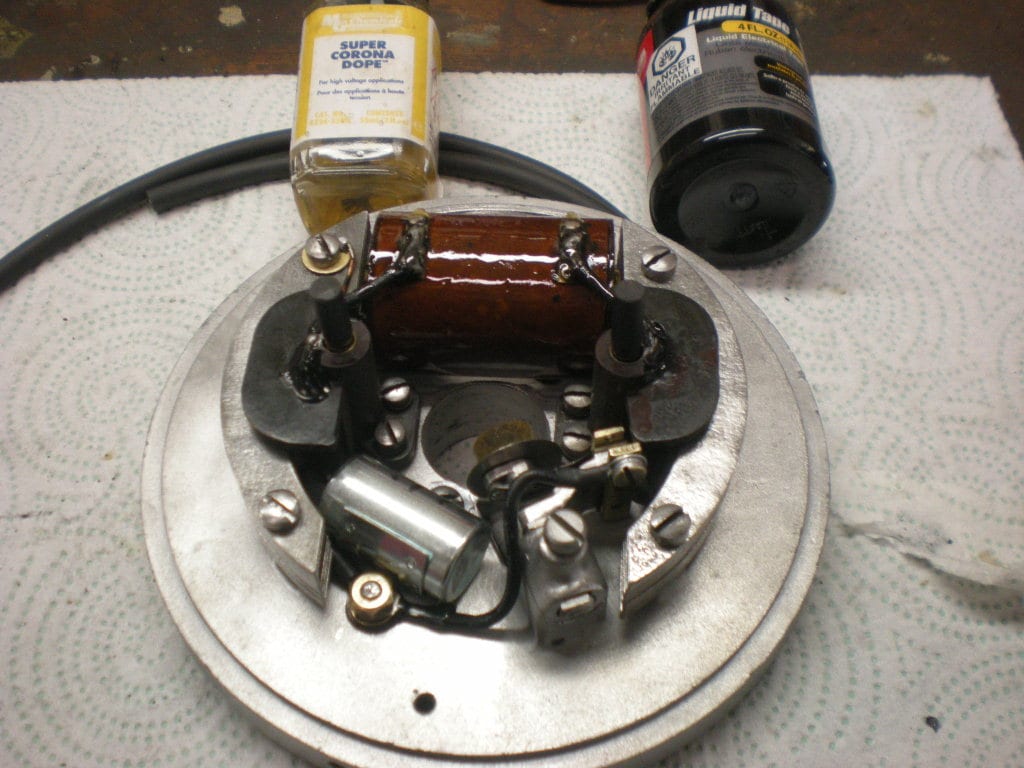

        The mag in my Johnson HS-10 just about put me over the edge a few years ago trying to get it to work right. I think Buccaneer has had some experience with these mags to.
        HS-10-Mag-Repair-014
        Here’s a previous post about these mags.

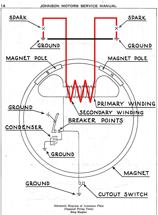

          #225100
            Those things gave me a fit back in “The Day” because I really didn’t understand them. But with what I know now, they aren’t all that complicated. It helps to first understand how it works as applied to horizontally opposed twins (picture below). When voltage in the secondary winding is high enough, the electrictal flow is as follows. It flows from one end of the coil, to a spark plug, jumps the gap to ground, THROUGH THE GROUND back to other spark plug, jumps the gap, and returns to the other end of the coil, completing the circuit. Thus, both plugs fire at the same time.
            With alternate firing twins, one end of the coil secondary is grounded by the carbon brush, Now the flow is from the ungrounded end of the coil, to the other spark plug, jumps the gap to ground, and back to the end of the coil that is grounded by the brush, completing the circuit. When it is time for the other cylinder to fire, everything is reversed and the other plug fires.

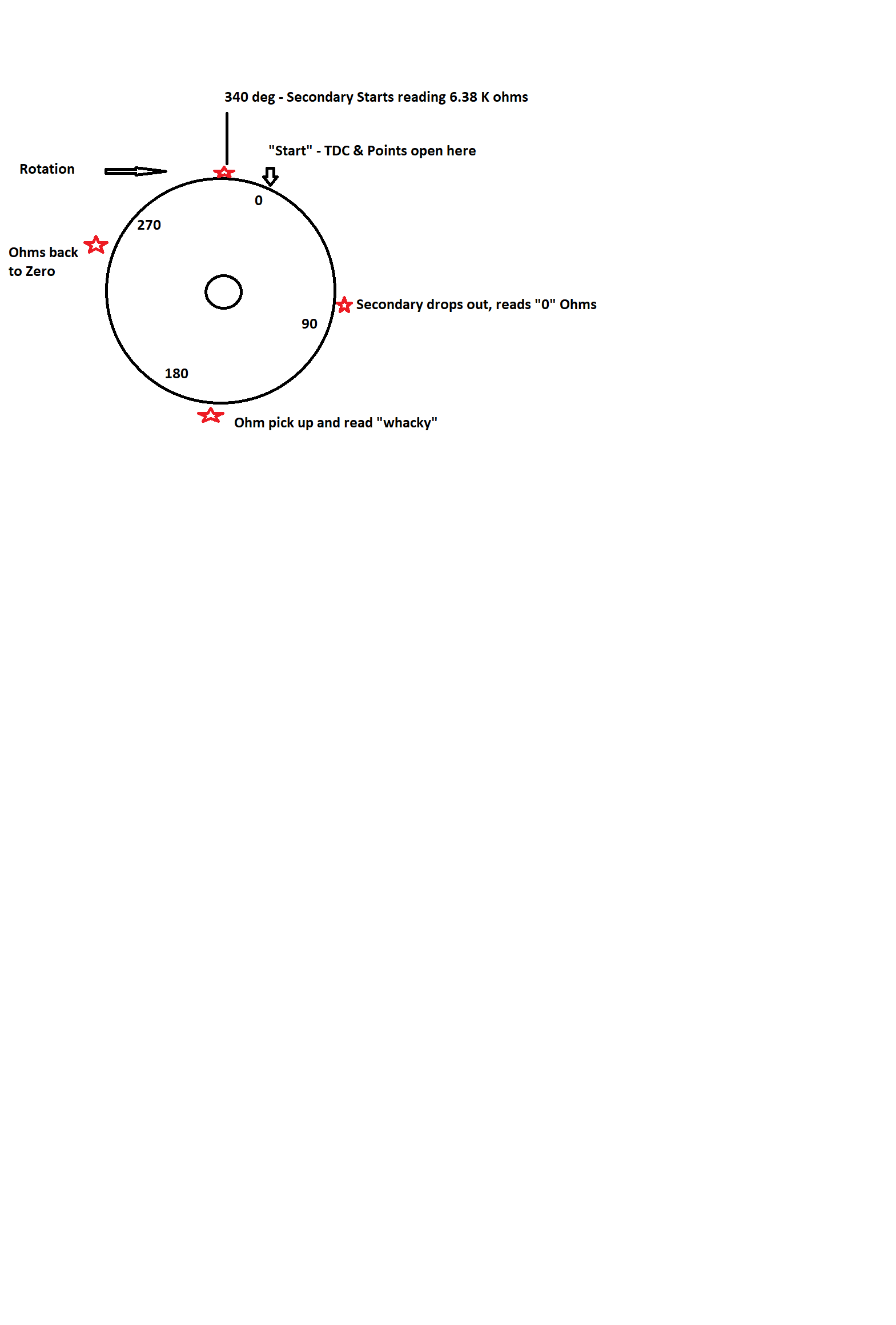

            #225107
              Nice explanation and graphic Frank.
              Back when I was trying to figure out the very erratic running HD-15
              with this “whacky” ignition, I did some testing and made a diagram
              trying to make sense of if things were working correctly as far
              as the coil grounding system.
              Thinking back, all I know is I was using an ohm meter checking continuity
              as I slowly spun the flywheel. I have no recollection of if the points,
              and condenser were hooked up or not, but I remember getting readings
              on the meter that made no sense.
              Perhaps one day I’ll try again, but maybe with a different flywheel if I
              have one, or can find one.
              HD-15-test
              #225114
                Just to elaborate a bit on these alternate firing twin mags, the crank has two cams ground on it with one set of points. When the points open, the current goes from one terminal of the coil to one of the carbon brushes, which is temporarily insulated from the flywheel ground by the Bakelite plate inside it, but connected to one of the spark plug leads. Then it travels to the spark plug, back to ground and returns to the second terminal on the coil via the brass plate which is temporarily in contact with the second carbon brush. This completes the circuit. The brass plate is electrically bonded to the flywheel by a small spring under the plate. As the crankshaft turns 180 degrees, the process repeats itself to fire the other spark plug, but now the opposite carbon brush is insulated from ground, firing the second cylinder.
                #225123
                  Buccaneer, if you did have the points & condenser hooked up, that would explain your wacky Ohms reading. The voltage generated by the magnets passing the coil was being applied to the Ohm meter. As you probably know, resistance readings cannot be done with power applied.

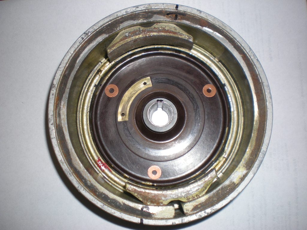

                  Michael Purpura
                    I had an inkling that the carbon conducted electricity and could only do so when in contact with the brass plate. What I am trying to determine is the length of the rods and how many of them. I have two springs and two rods but they are different lengths.
                    Is the single set of points adjustable and is it gapped to 0.020”?
                    Is there any adjustment that I have to do to the carbon rods and springs before I put the flywheel back on?

                      Michael Purpura
                        That is how my flywheel looks. Just need to make sure I have the right dimensions on those carbon rods. I may have to make new ones
