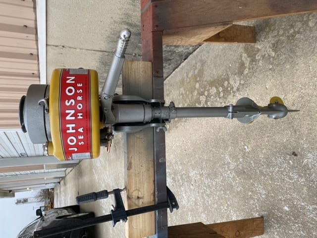

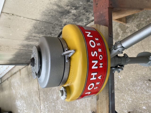

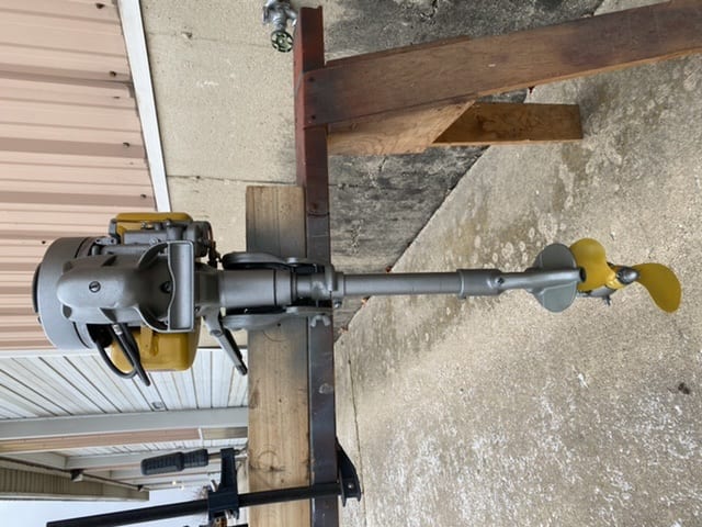

          #236965
          Michael Purpura
            Once i turned the rods and reassembled i got the engine to run. She runs smooth and goes right up to full piwer. Inwill take her on the lake in a few weeks. Thanks fir the help

            #236980
              Nice, I like the “Tweety Pie” yellow!
