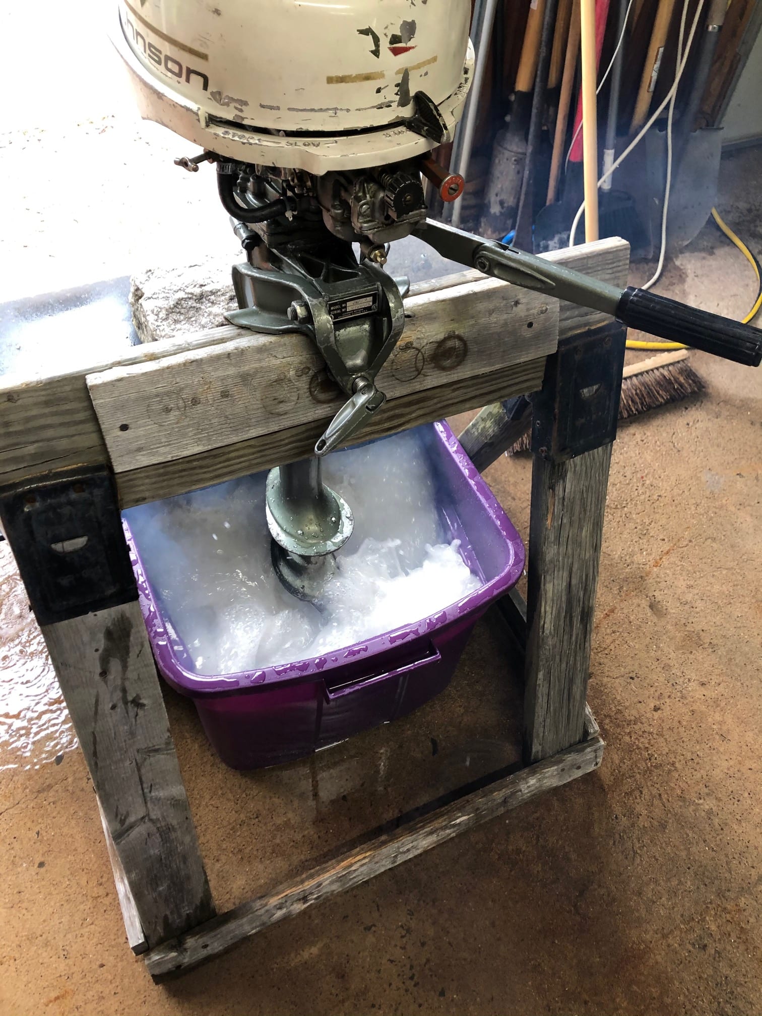

        Finally got her together and got her to run, unfortunately both gaskets around the reed plate leaked a lot. Got them on order, getting there.

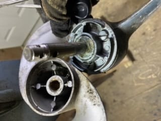

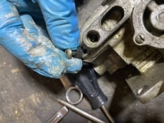

          I have a 5d10e Elto. Where would o get a seal for the bottom gear case where the prop shaft exits the housing, and , my carb is missing the drain screw near the fuel inlet . I plugged it and the little drain hole with screws

            Prop shaft seal is part number 41-62, changed to 307563, changed to 0321788. Any Evinrude dealer.
            Yeah those holes used #10-24 brass screws with fiber washers. Any “real” hardware store.
            #228110
              When you can’t find the part number for the seal, or when Frank takes a day off,
              you can input the shaft and bore size in this site
              and see “what’s available”, then you have lots of options on where to buy said seal.
              http://www2.chicago-rawhide.com/popup_parts_lookup_457010.htm

                Finally!

                  Smoke on the water is a good sign!
                  #228381
                    It’s always satisfying when a motor is back together and running!
                    Just a suggestion but you should block the tub up higher or use a deep bucket as these pumps aren’t designed to lift water and the water level should be up to the pump at least.
                    #228448
                    swamp yankee
                      Definitely need a better set up, I thought I had a better bucket but it didn’t fit in between the legs of the stand. Motor would idle low but it seemed like i had the knob almost all the way in, it was cold out. I didn’t run it very long. Need to put some time into the 67 crestliner hull it came with, the original plan was to flip them to get something a little larger for spring.
                      #228465
                      outbdnut2
                        If you ran it that way for any length of time, your water pump impeller could be shot from running dry
