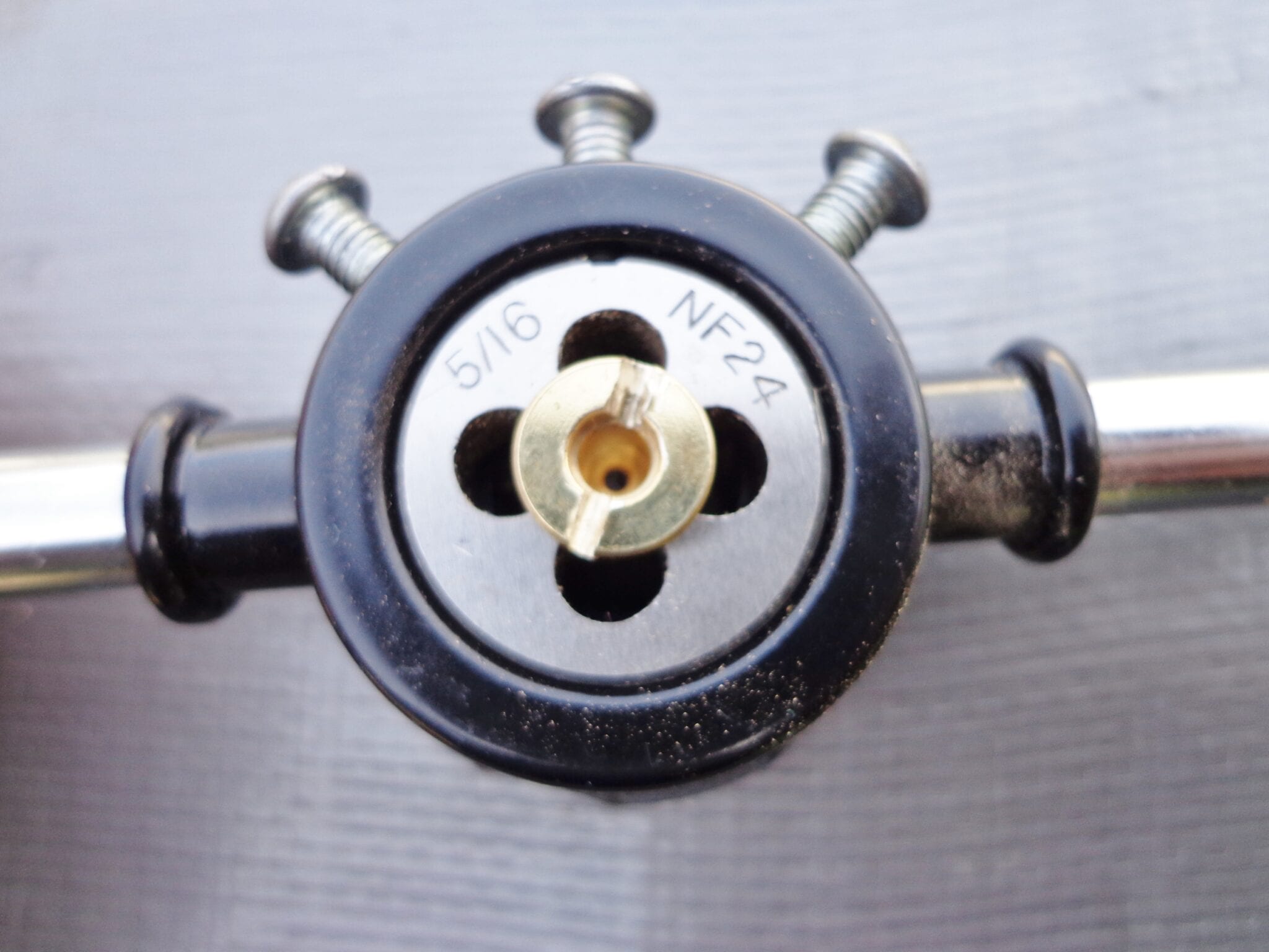

                    The threads are 5/16 – 24 and I like to run the it thru the back side of the dye after running it thru from the front side. This way the threads get cut all the way down to the head. The original screwdriver slot is pretty small to so it can get enlarged with a Dremel.
                    DSC00090

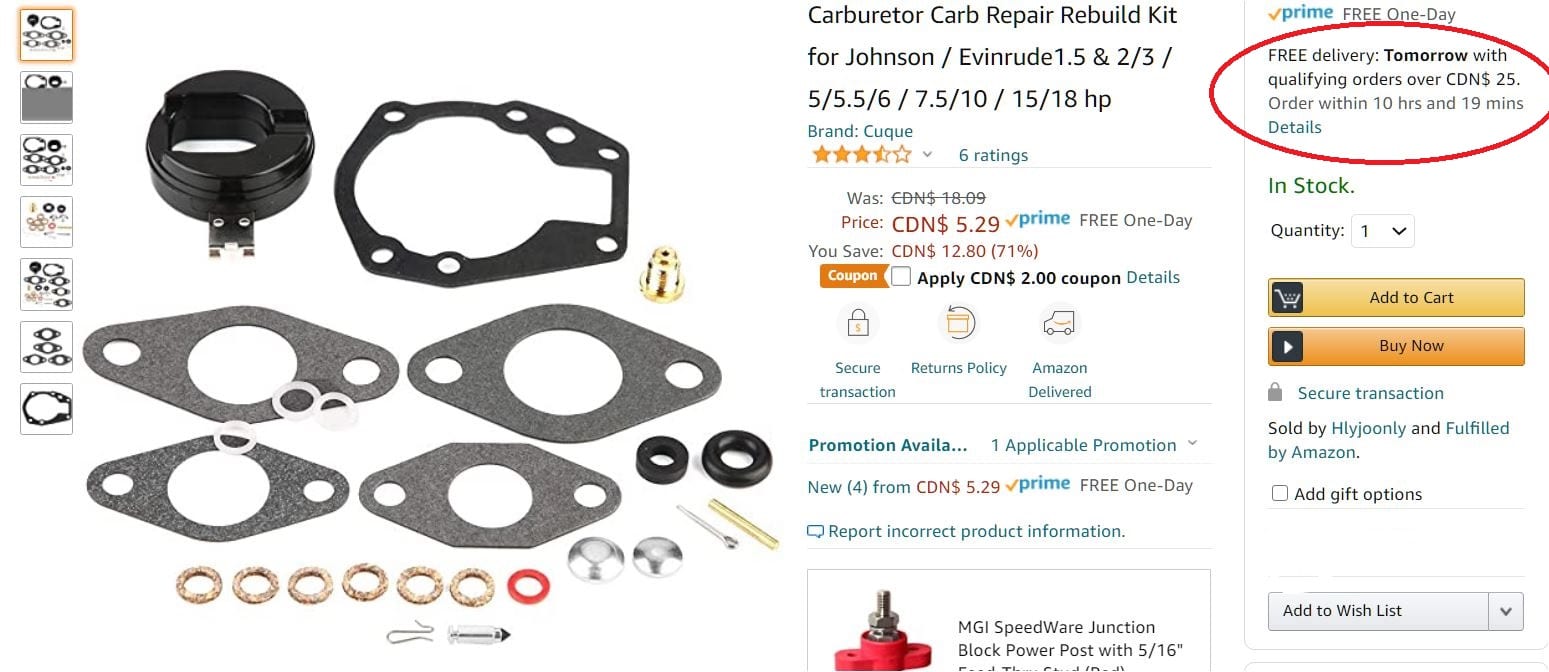

                      I’ve used some of these style Chinglish kits in the past and haven’t had any problems with them yet, although the motors with them on haven’t been used much. One thing I found besides the float valve threads needing chasing was the plastic washers for the packing washers are too large and I had to use some spare left over ones. Maybe I should pull a carb off and check the condition of the gaskets as It’s been close to a year now.
                      These cheap kits are also ‘Add On’ items with a purchase of $25 or more. Time to go shopping soon!!
                      Carb-Kits-
