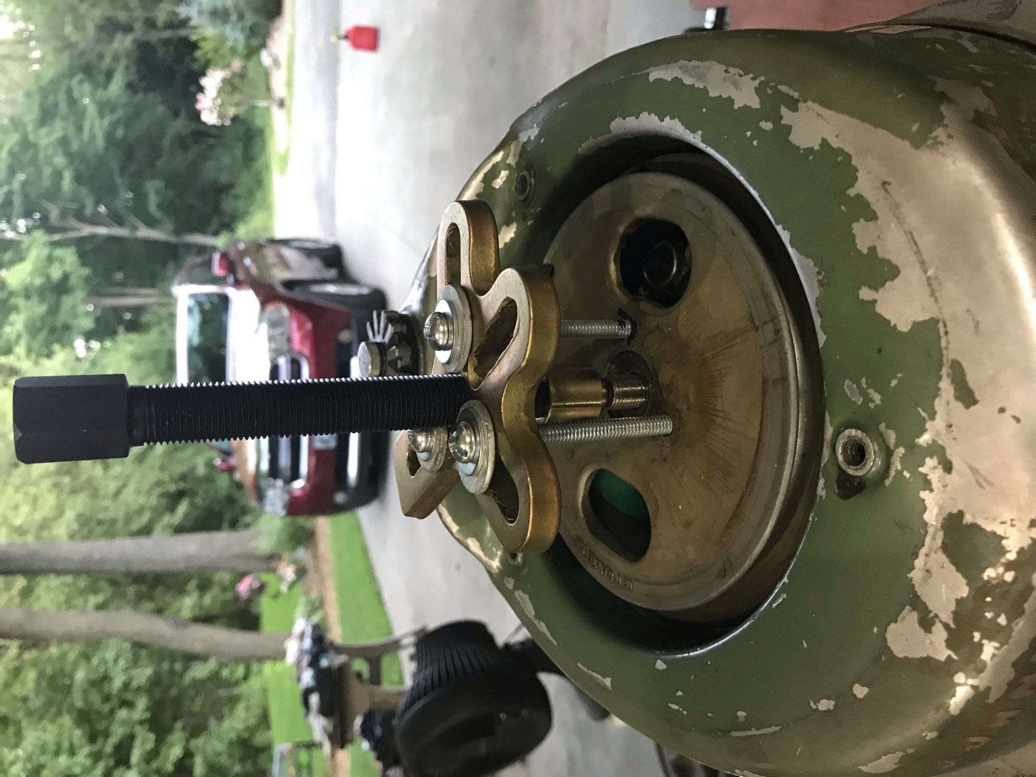

          When removing the flywheel it may pop but not leave the motor. Tighten up the three smaller bolts EVEN but not into the coil under the flywheel. Tighten the center “remover” bolt until very tight, then tap on the puller bolt to loosen, repeat. Never go too tight as to pull the threads out of the flywheel. It will come out..

            Thanks all. See attached pic. So you are saying, have the bottom of the screws not go into the threads at all? Just line up with them? So then just tap the black center bolt until it pops or comes lose?BTW, in this pic, the screws (I bought and tried a variety of machine screws and bolts to see which threaded the best) are threaded in but not past the bottom of the top of the flywheel if that makes sense.

              you must turn the center bolt (3/4inch) to pull the flywheel upwards and it will suddenly pop loose
              #182243
                You should be using grade eight 1/4 X 20 bolts with the puller. The screws you’re using look like cheapo screws from Home Depot and they will stretch or snap off (usually in the flywheel) if over stressed. Once you get the motor running, use 16:1 fuel mix in it. Any TCW III two-stroke oil will work fine.

                  Thanks. I think I was misreading earlier some suggesting NOT to thread the three screws into the flywheel. That was confusing me. All the videos I’ve watched show them threaded into the flywheel before turning the center bolt for removal. I will get the better bolts.

                      BTW, popped the flywheel off tonight. Will work on the coil and everything this weekend. Also changing the impeller, I have that lower unit disassembled now. I will check the Johnson service manual Mumbles sent but any lube needed on that after cleaning everything out?

                        I posted the screw instructions. Many have taken the screws deeper than the threads of the flywheel & destroying a coil underneath. Know the depth of the threads on the flywheel & use all the threads to get a good bite but no deeper please. Sorry for the miscommunication. Measrure the three points of hardware to get the puller level with the flywheel to get a straight pull.
                        Jim is correct, you need at least grade 6 or 8 1/4 x 20 hardware to stay out of trouble!
