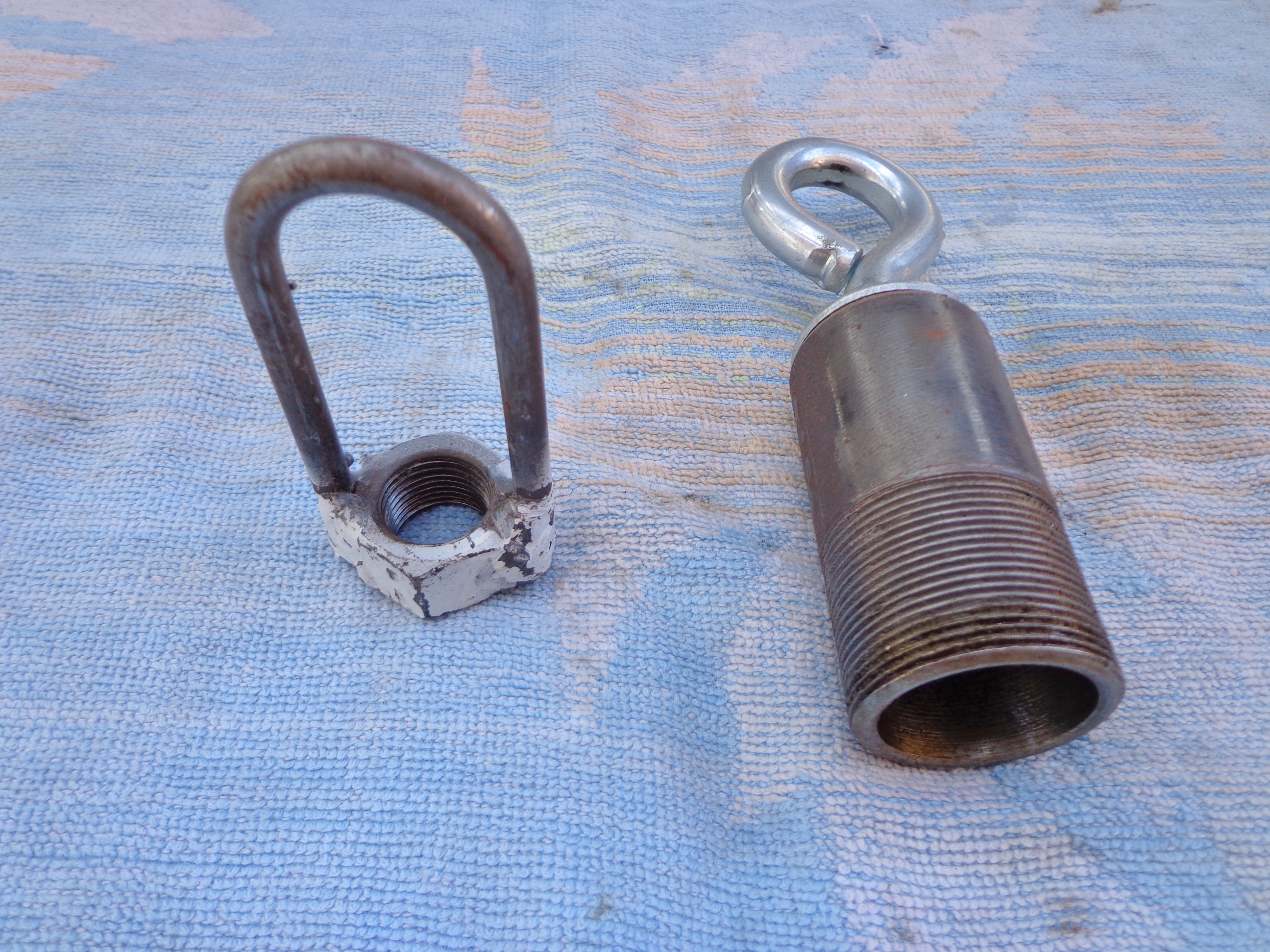

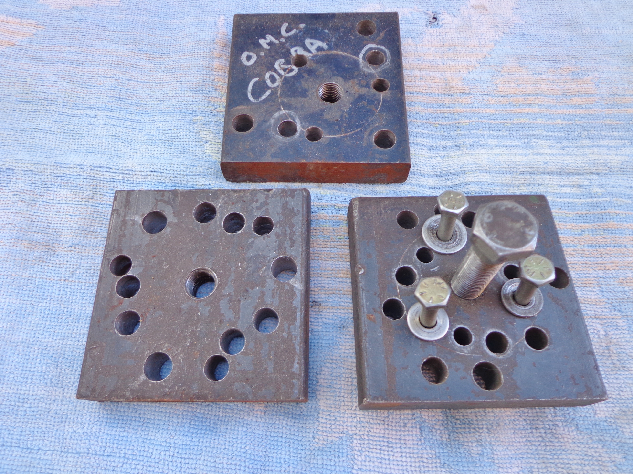

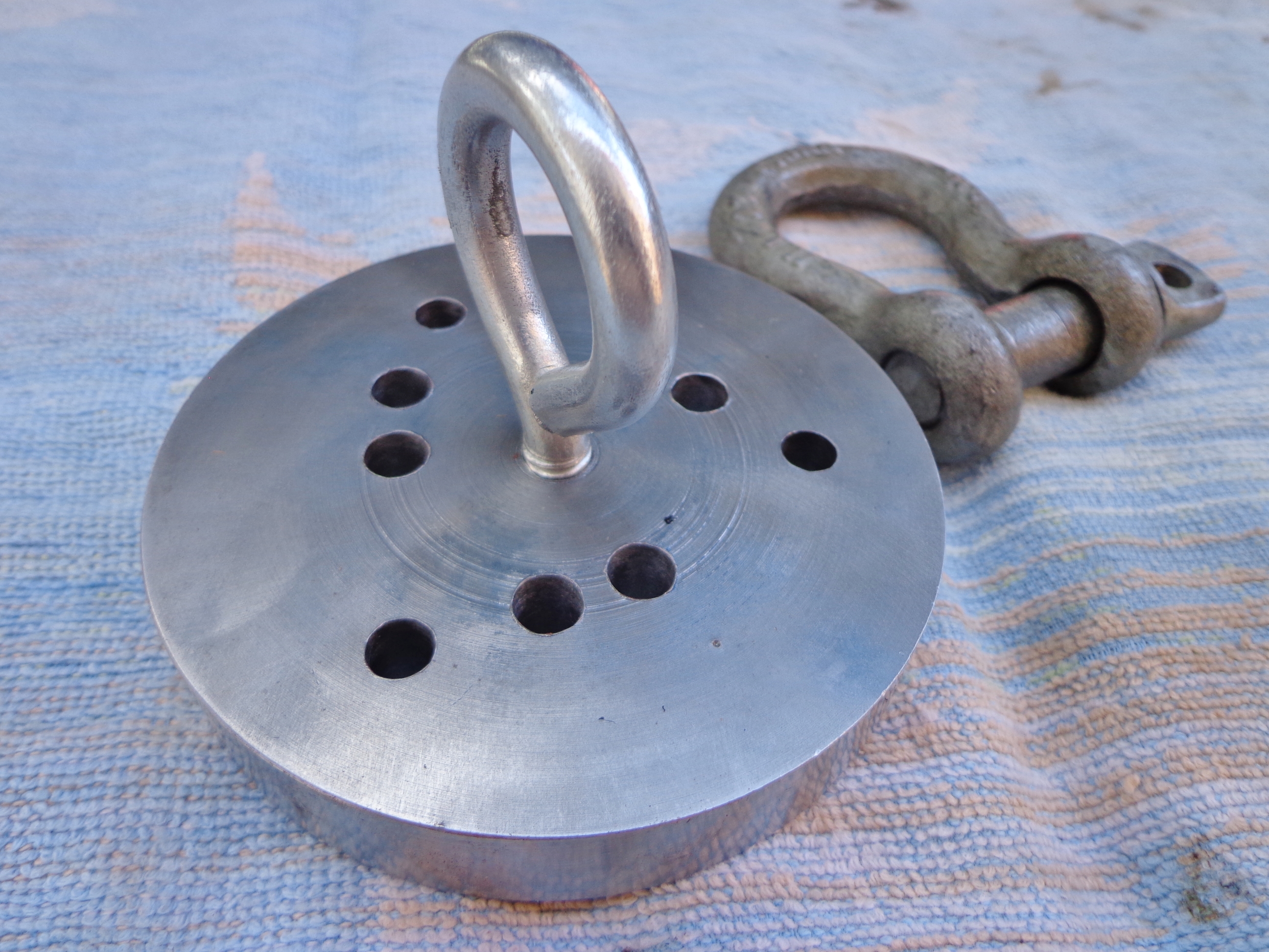

          If you don’t want to shell out big bucks for pullers or lifting fixtures, you can always make your own. 3/4" seems thick enough for a flywheel puller and a cookie of 4" round works for a universal lifting plate. A piece of 1/4" rod bent and welded onto a nut will lift motors by the crank and a piece of pipe externally threaded is used for the big uns from the Dark Side.

            The first couple of years working on these smaller and older motors (25hp and below prior to 1977), a harmonic balancer worked. In the last couple of years I’ve been able to piece together the OMC puller and various accessories (more or less) original to the kit, and there is no comparison. Even the middle size motors I work on now (up to 70hp into the 1990’s/2000’s), you need at least 100 ft-lbs of torque to tighten the flywheels down, let along break them lose (a lot more than that in most cases).
            Always get a kick out of when those suckers go POP on removal. 4′ cheater bars aren’t always enough!

                  Just a quick story to maybe put this topic to bed. My son (38) was pulling a V-4 powerhead for me while I was at Constantine. I have instructed him to always break the flywheel loose before pulling the powerhead. (He is a bike guy, not outboard nut like me).Anyway he knows my tools and proceeds to put the OMC puller on to pop the flywheel. Him & his buddy have trouble getting the flywheel to give. After a call to me and some confusion (pic sent by text) I discovered they had the puller plate upside down. By the time I got back to him the flywheel had popped. Now even with the tapered side of the plate upwards the puller still pulled the flywheel without breaking the shoulder bolts. Of course I wouldn’t recommend doing it this way. He just made a mistake. Never thought about turning the plate over even though he saw the bolts leaning out. Funny how sometime thing’s just don’t dawn on people. He has seen me do this a 1000 times.
