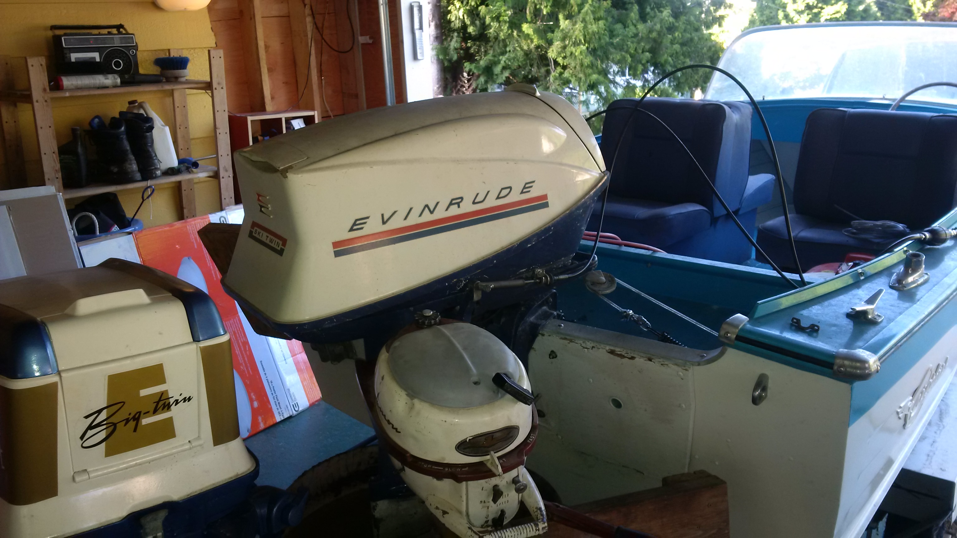

              wetwillie
                I could pry it (with wood in place) but would be a little apprehensive about applying so much force to such a small contact area under the flywheel and to just one side of the flywheel.
                I found a small sledgehammer in my garage this evening and took a couple of whacks at it. Nothing. I’ll leave it under tension tonight and try blasting the interface with a jet of cold air after heating the surrounding area with a Bernzomatic.
                Surely, this thing will let go eventually.

                  wetwillie
                    Gotcha Steve, and you’re absolutely right! I’ve become so focused and getting the flywheel off that I forgot the purpose of prying it up.
                    Personally, I’m pretty proud of the set up I devised with the whole motor being supported by it. lol
