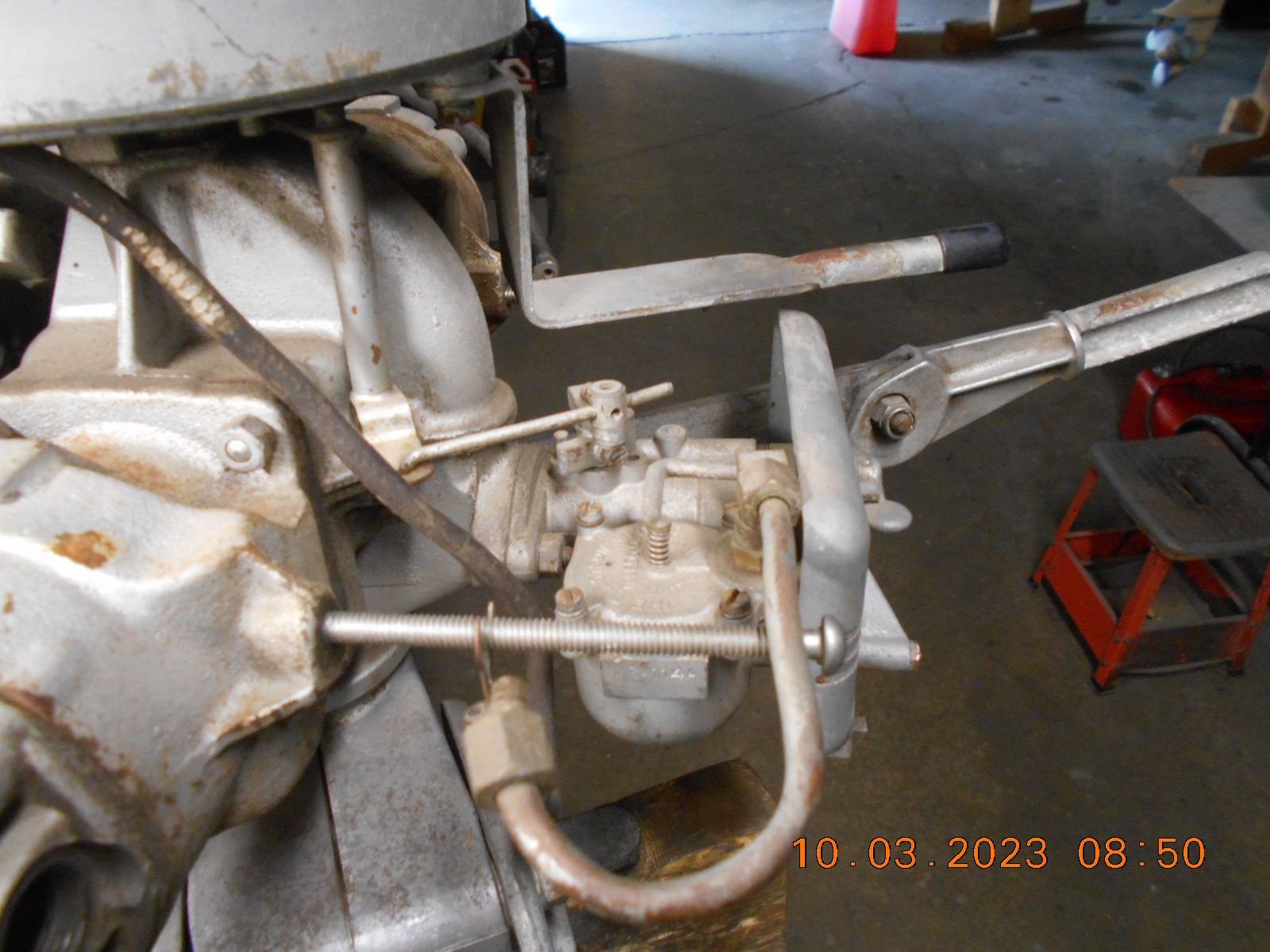

April 8, 2024 at 5:20 pm #286583I cant figure out how the throttle works as the linkage to synchronize the mag and carb are missing. It was stuck but came loose as soon as I tryed to take the flywheel nut off.
April 8, 2024 at 8:42 pm #286587I cant figure out how the throttle works as the linkage to synchronize the mag and carb are missing. It was stuck but came loose as soon as I tryed to take the flywheel nut off.
Here’s some of the linkage on my 2G
