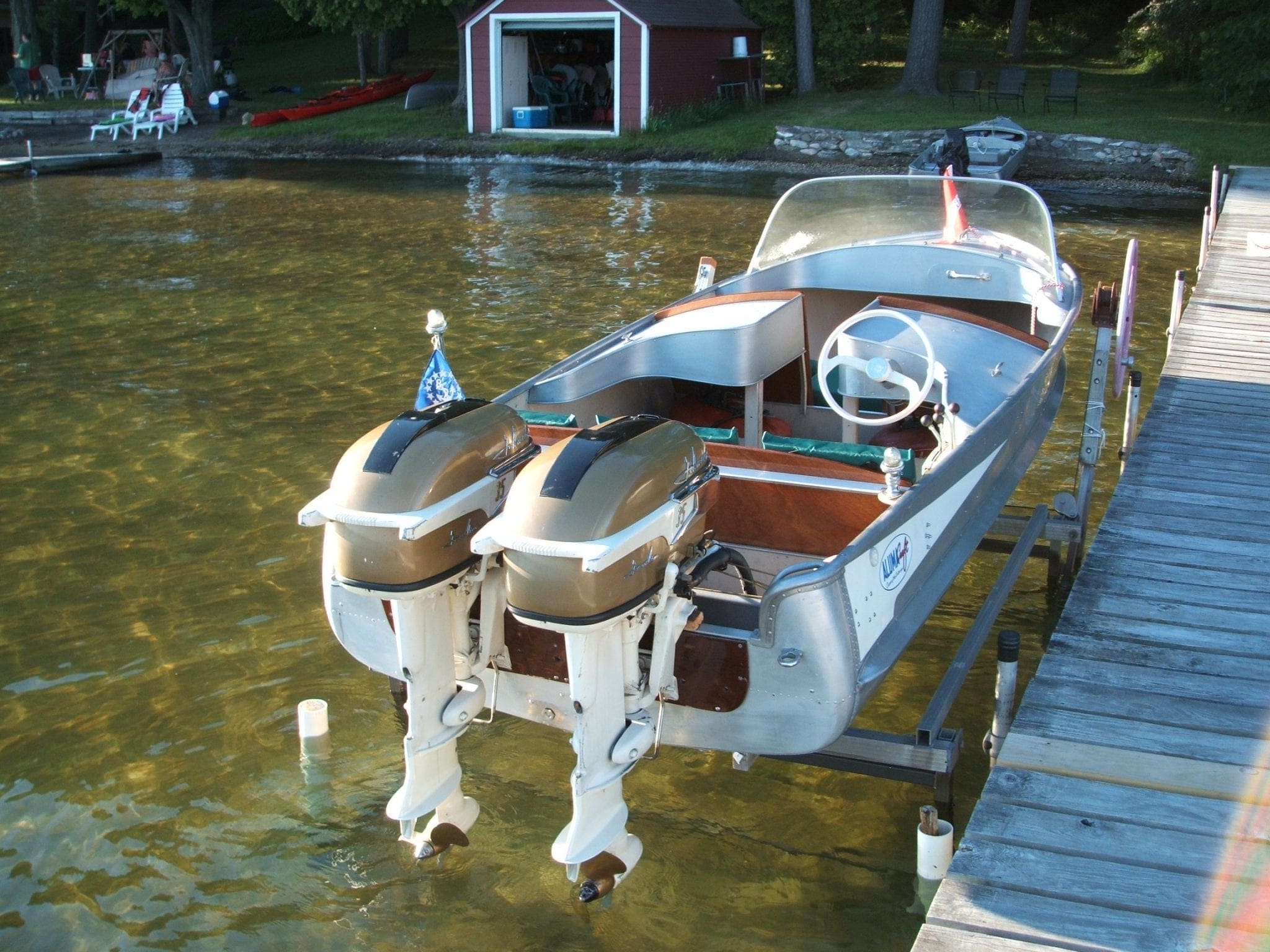

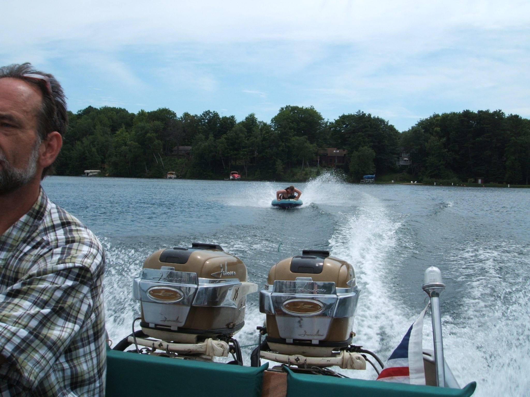

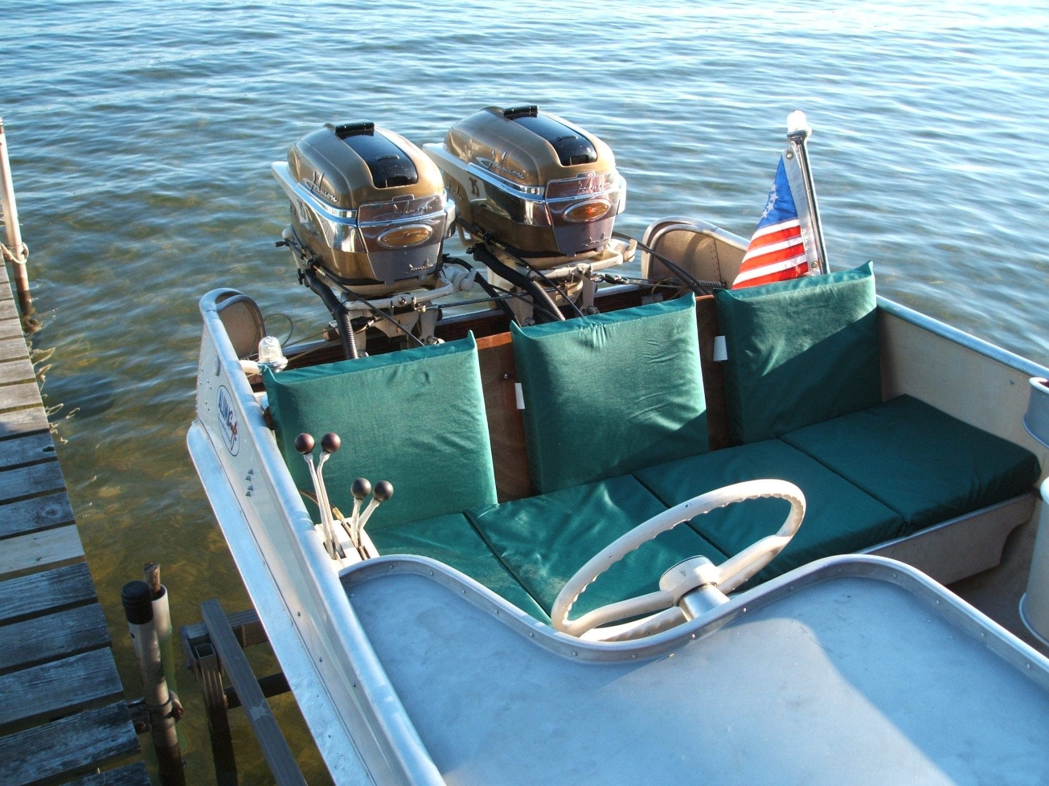

                  It’s not rocket science but it’s lot’s of fun. And you can easily synchronize them by ear.
                  2011_0703BoatsFlanneryBob0012
                  2011_0703BoatsFlanneryBob0015
                  2011_0705BoatsFlanneryBob0001

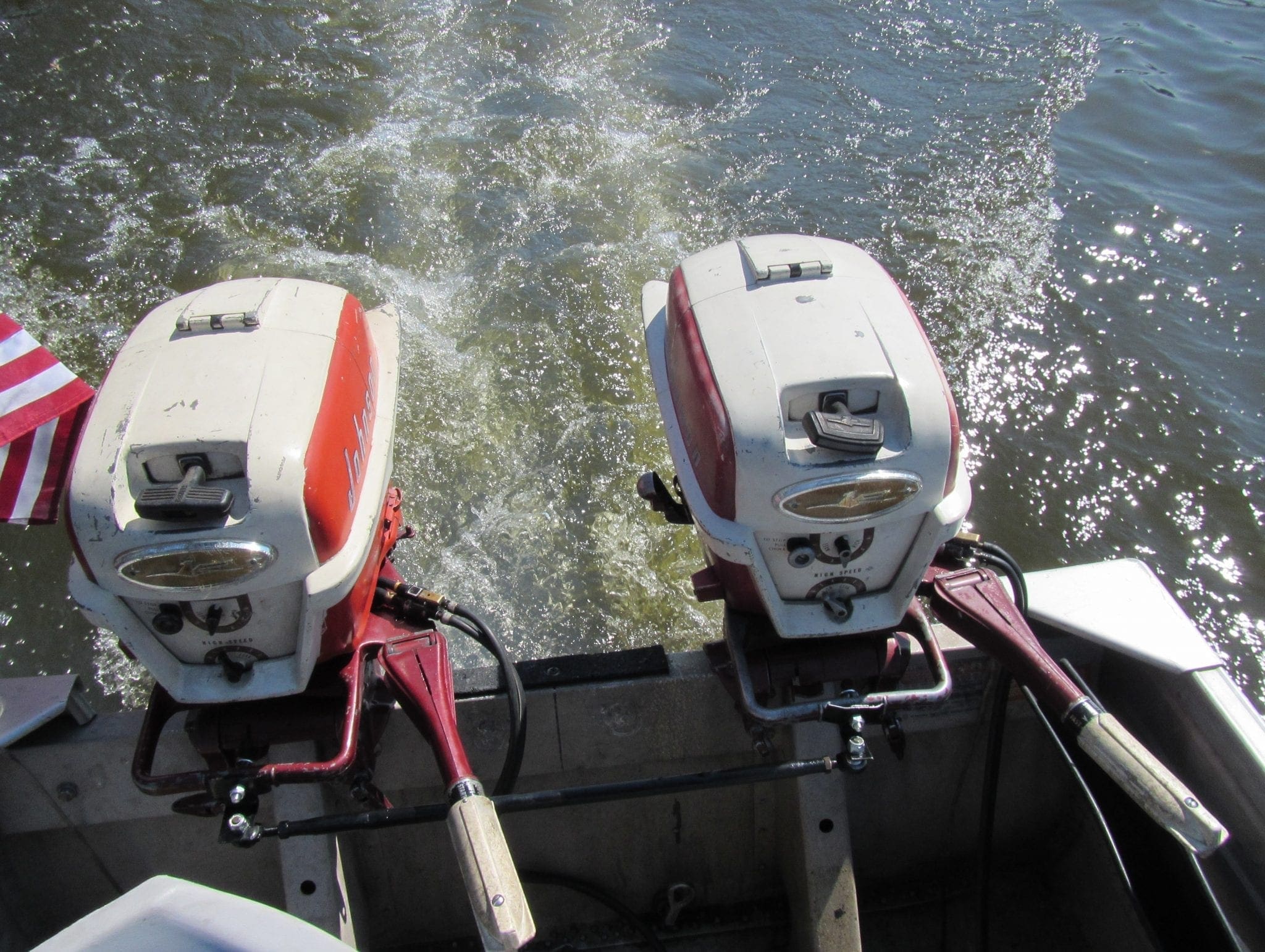

                    Dale
                      I ran a couple 10hp Johnsons on my 14′ MiroCraft a couple years ago. Didn’t do anything out of the ordinary getting them on the transom. I used a snowmobile steering rod and tie rod ends to hook the motors together. It was fun, I might try that again one of these days. Kind hairy when you first dump the throttles open. Need some weight in the bow for sure!
                      dale
                      IMG_0836

                      20mercman
                        I have run twins several times, but every time it was just two motors that I had to individually control by hand. I like the set-ups shown with the steering rods. In the past, I have run two Lightwins, neutral clutch Fleetwins, Mercury Mk-5’s, Scott Atwater 3.6’s, two Mercury KE-4’s, two 110’s a 110 and 4.5 and a 110 and QD-21, and finally two Mk-20’s. The two Mk-20’s was on our Lund S-14. That thing flew! I would really have liked that steering bar then. It was also pretty LOUD!
                        • This reply was modified 7 years, 4 months ago by 20mercman.
