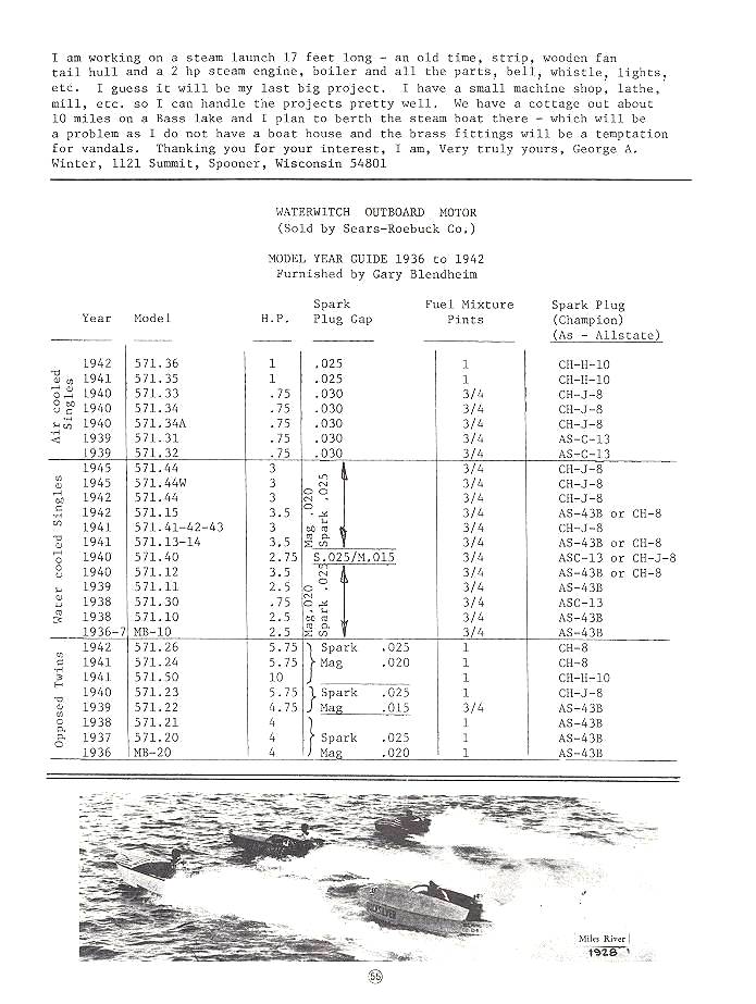

      Probably one of these models!
      1936-to-1942-Waterwitch-models

          There should be a model number stamped somewhere. Either on the rope sheave or on the crankcase and probably starts with 571.XX.
          Waterwitches were built by several manufacturers so depending on the model, it could have either a Wico or an Eisemann magneto on it.

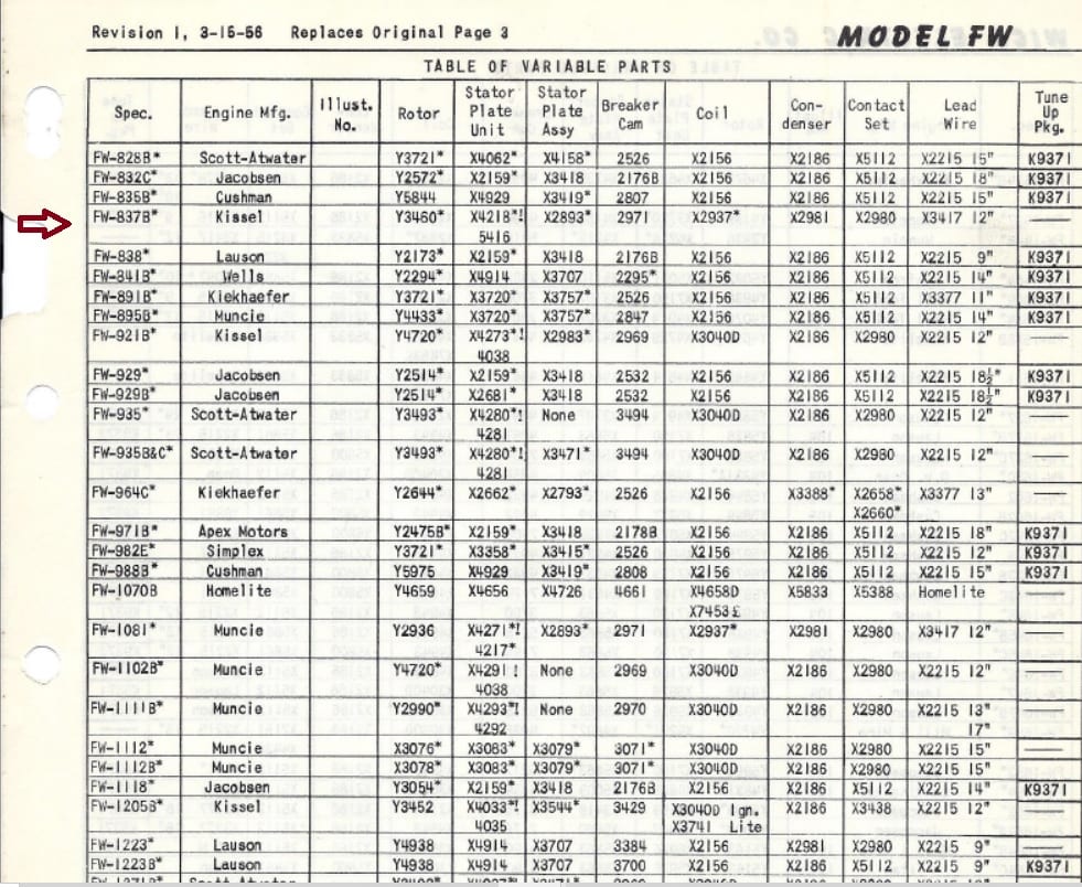

                #227623

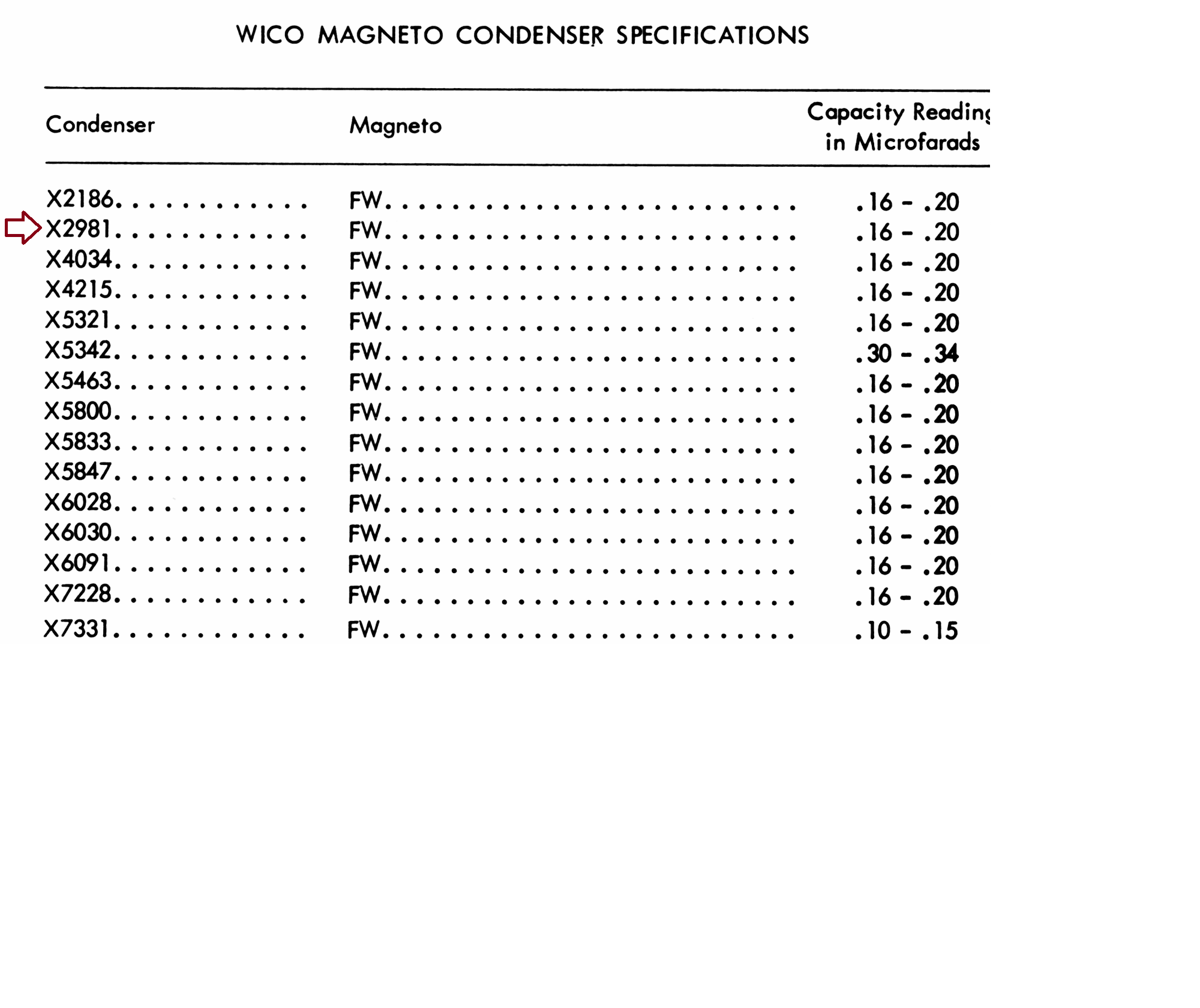

                  Wico
                  #227626
                    Wico-X2981
                    #227629
                    AnotherSteve
                      Thanks again Buccaneer.
                      Ah to be young and foolish again instead of old and still foolish.
                      #227656

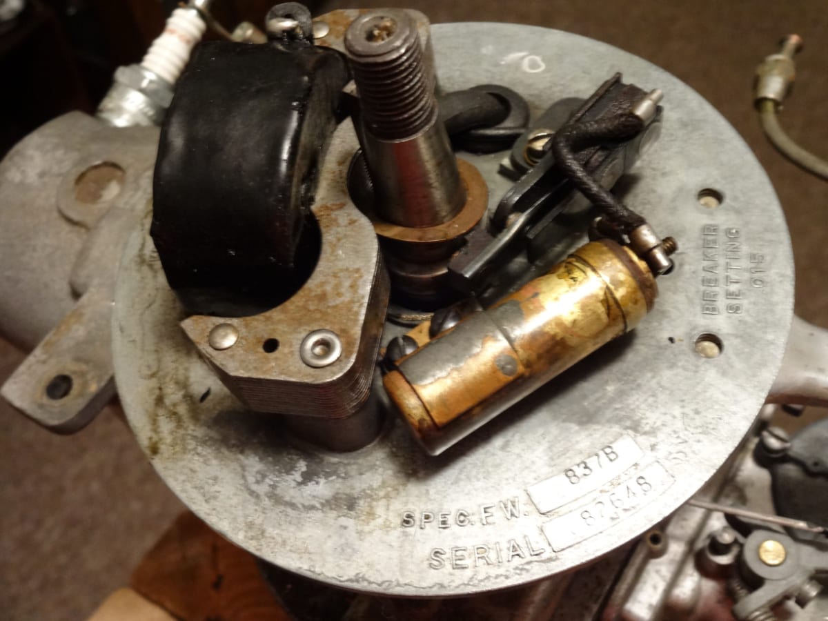

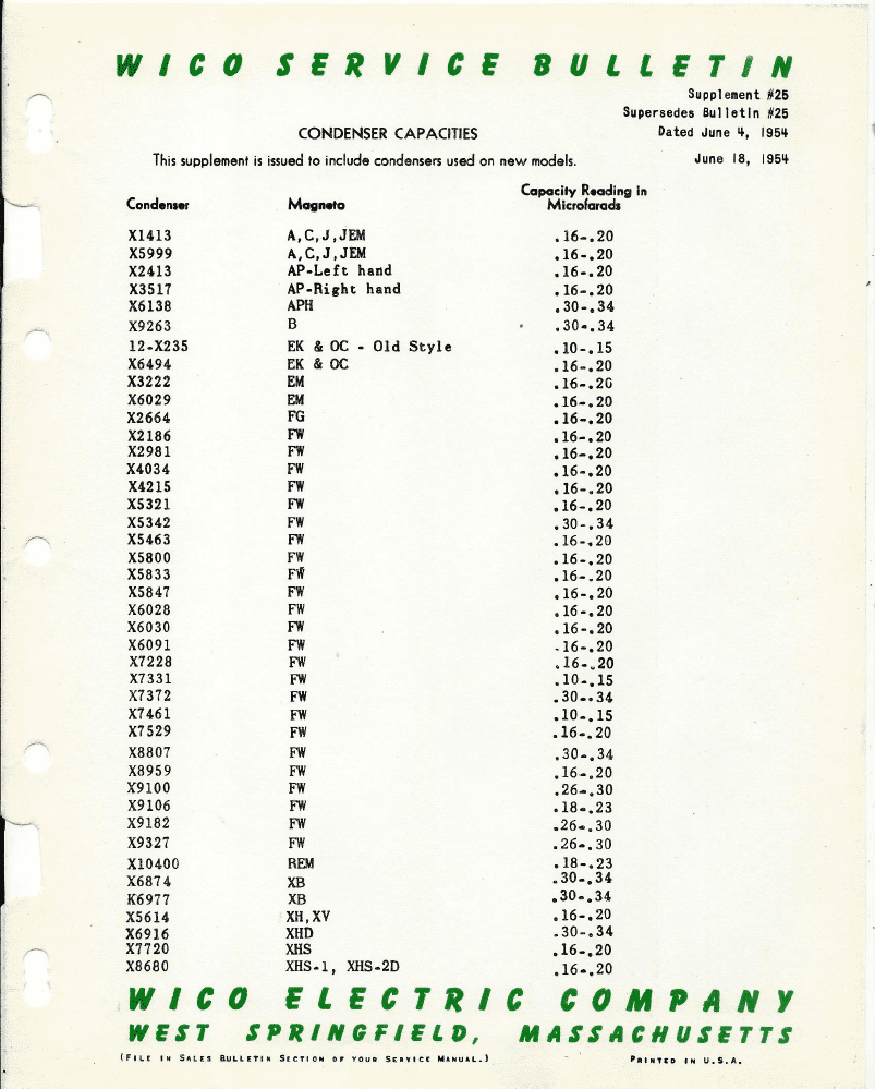

                        OK, it’s a Wico FW (Fly Wheel) 837B? I can’t find any listing for that particular model so you are going to have to see if there isn’t a part number stamped on the condenser itself somewhere.
                        Most, but not all, FW mags used a condenser (capacitor) with a rating of .16 – .20 uF.
                        Wico-Condenser-Values
