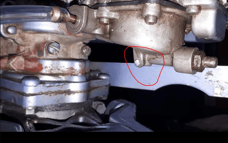

The lower hex train plug – you mean part 34 in the carburetor parts diagram here
https://outboard-boat-motor-repair.com/Evinrude%203%20HP%20Lightwin%20Outboard%20Boat%20Motor/Evinrude%20Johnson%203%20HP%201952-1954%20Parts%20Manual.htm
Upon close inspection it appears that this has been snapped off at some point!February 27, 2020 at 4:43 pm #195999Thanks everyone.

Upon close inspection it appears that this has been snapped off at some point!February 27, 2020 at 4:47 pm #196002So looks like I have a blockage still.
February 27, 2020 at 5:33 pm #196007Th blockage was inside the carb. As far as I can tell the float is not ‘adjusted to level’ properly. it seems that although the needle valve works with the bowl off (tested by blowing in the inlet with the bowl off and lifting the float up and down) it is not horizontal which means putting the bowl on permanently closes the valve.
February 27, 2020 at 5:35 pm #196008No, not #34 in your drawing….The big 7/16″ hex plug right in front of the carb….Remove that plug, fuel should flow from the carb with the fuel valve and air vent open….
