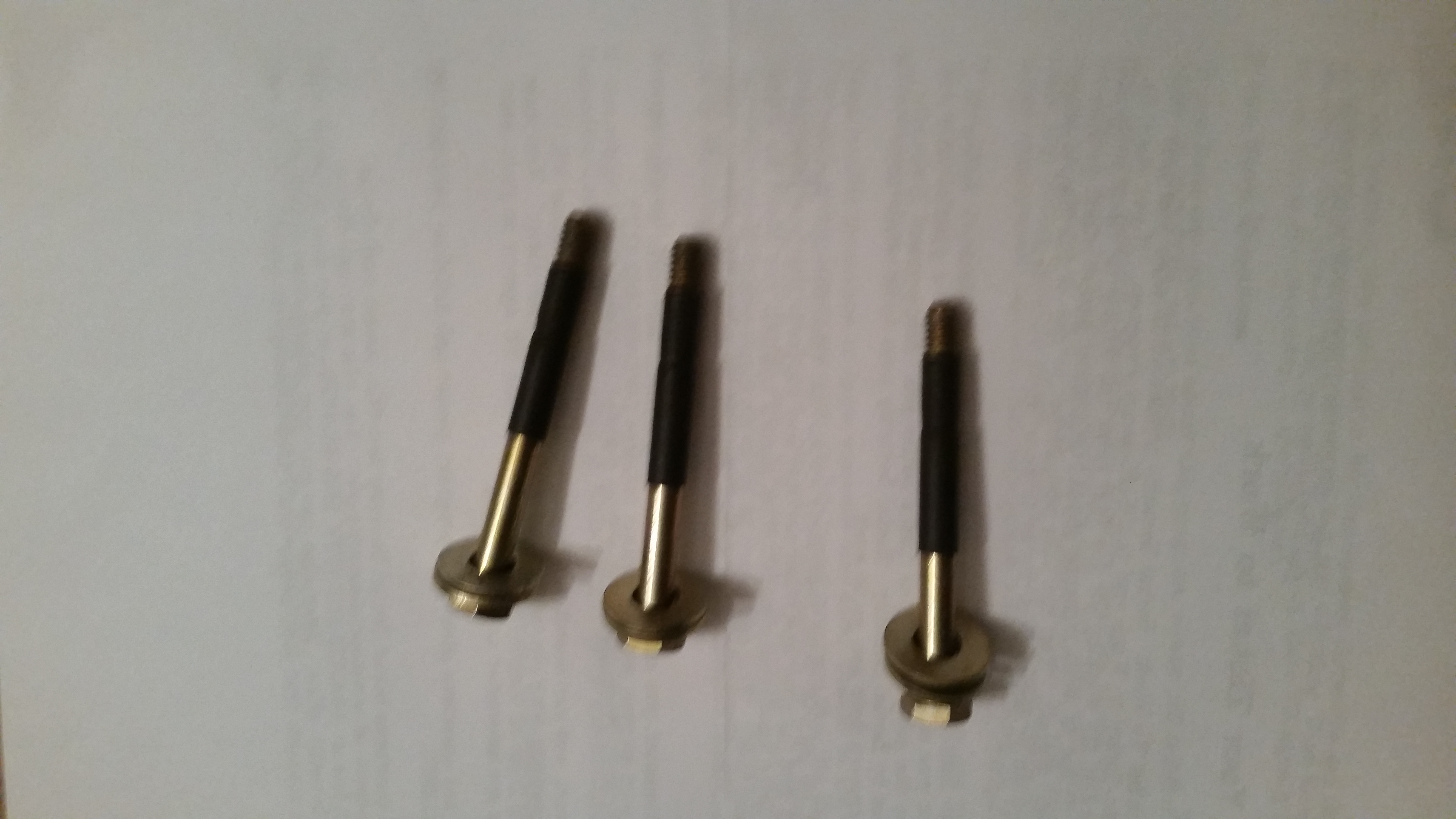

This morning, I bought another set of bolts, used Steve’s idea of marking the length with shrink tubing (excellent & thanks) threaded them in and applied some serious force to the center bolt.

July 30, 2016 at 4:37 pm #41236quote Steve A W:Just a little quick tip.
On my puller bolts I put electrical shrink tube on them
so there is only 7/16 inch of threads showing.
Can’t run them in too far with this.Steve A W
Excellent idea Steve. I had used masking tape in the past, but heat shrink is a way better idea :ugeek:

AlJuly 30, 2016 at 5:35 pm #41239quote Wedgie:quote Steve A W:Just a little quick tip.
3/8 OD poly tubing also screws right onto the threads using a pair of channel lock pliers. Makes a nice shoulder but not one you want to tighten up against as it will move.
