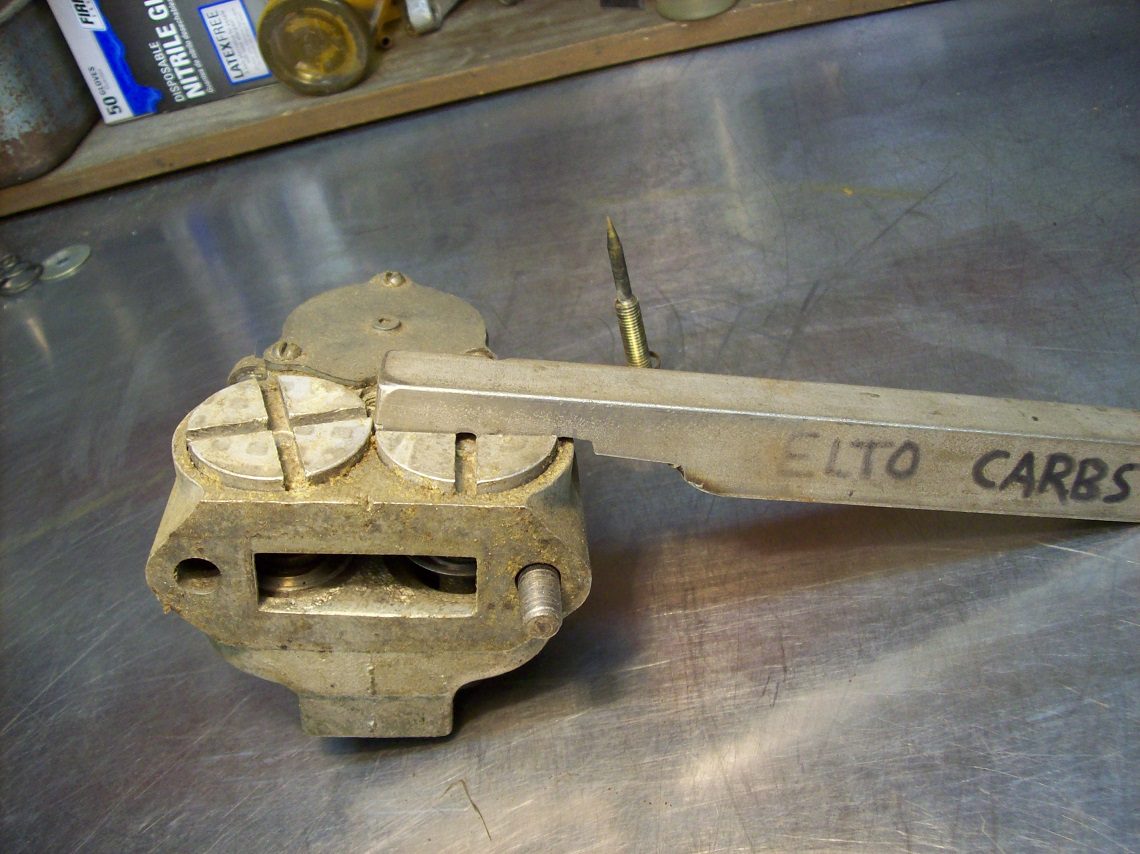

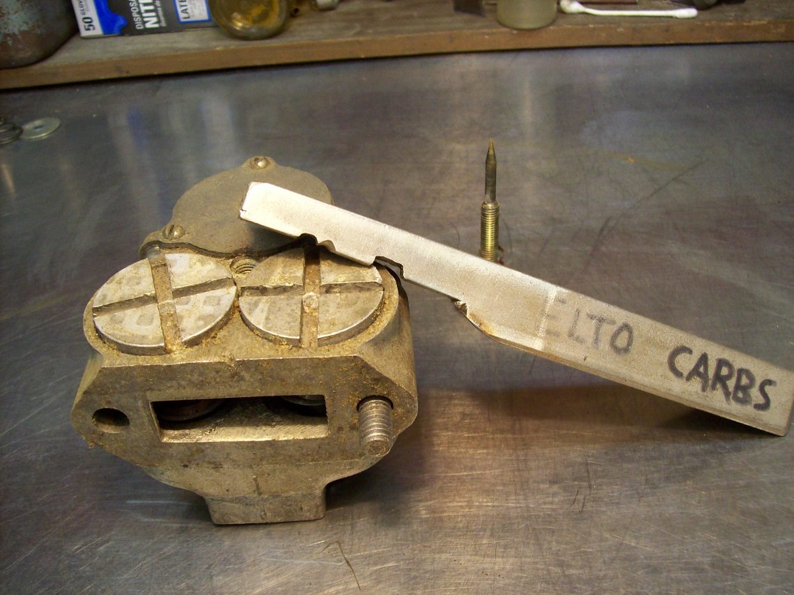

      Best to have the carb screwed down tight onto the motor for cap removal. They can be tight.  This is the tool I made from stainless steel which was handy and strong. Keep sharp edges on it for grip. A notch may have to be filed to provide clearance for the center peg that sticks up and for the greatest grip. I made it shallow to clear the coil.

          Mine is similar to Harry’s. Also stainless steel.
          On tight ones or on ones that are chewed up
          I clamp my tool into a vice. Then I can push
          the mixer into the tool hoping the tool will
          stay in the slot till I can get the cap to break
          loose.
          If they are so bad that wont work I clamp the
          cap in the side of the vice and twist the mixer
          to break them free. The jaws of the vice must
          be straight and square for this to work or the
          cap will slip out. Brass or aluminum jaws
          prefer but if there really chewed up it really
          doesn’t make that much difference.
