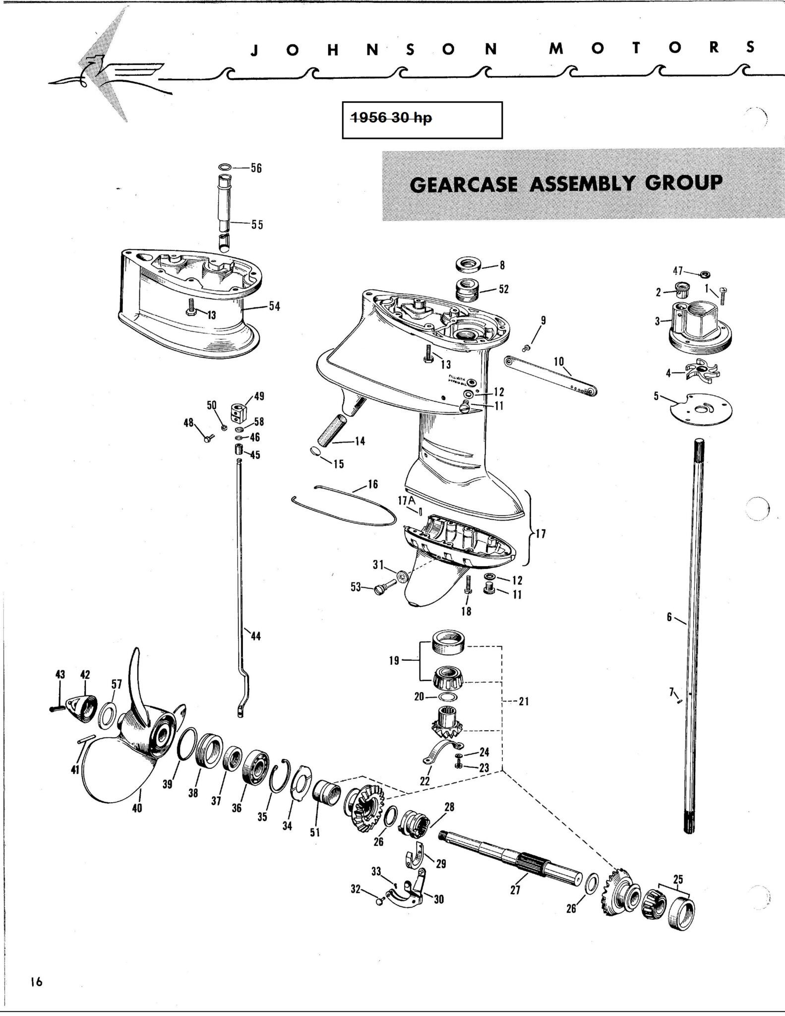

              That GC two is off a 1956 30hp.

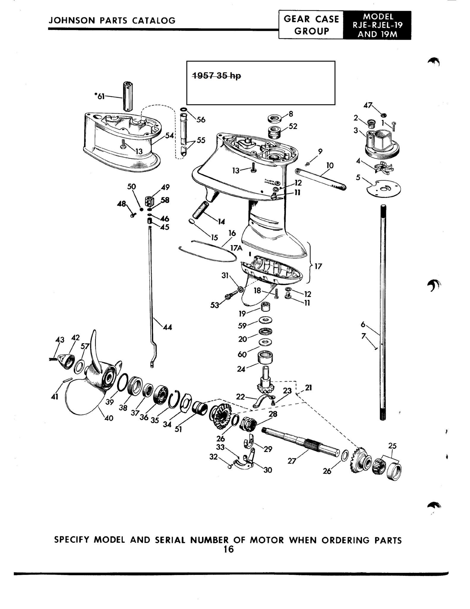

                I have been lurkering this post
                I was wondering the original colors of the two gear cases
                1956-30-hp-gear-case
                1957-35-hp-gear-case

                  So I put all the rusty parts back with GC one, now known as the 35 hp gearcase and  put the other gears back into the 30 hp gear case.  Both turn now.  Probably work a little better with some lube in there, but the problem seems to be solved.
                  As far as original colors, both gear cases were pretty rough looking.  The 35 hp gear case was done in what was left of a coat of gray.  The 30 hp looks like it has something green left on it.  My guess is that one came off a Johnson.
                  Any reason I can’t run that 30 hp lower with my 35 big twin?

                    The 1957 Evinrude 35 hp lower unit , tower and engine were painted light grey.

                      Well, it is like I say.  These gearcases all seem the same, but there were many little differences.  And while the complete assemblies can be used on many different engines, swapping the internals can lead to trouble.  The pinion set up is different, am thinking the forward gear tooth set up is different as well.  Good learning tool for all of us, we have all been guilty of swapping stuff around from time to time…

                        Any reason he can’t run that 30 hp lower with his 35 big twin?
                        I’m thinking since the one gear case had green-It really is off a 1955 RD-17 Johnson 25 hp.
