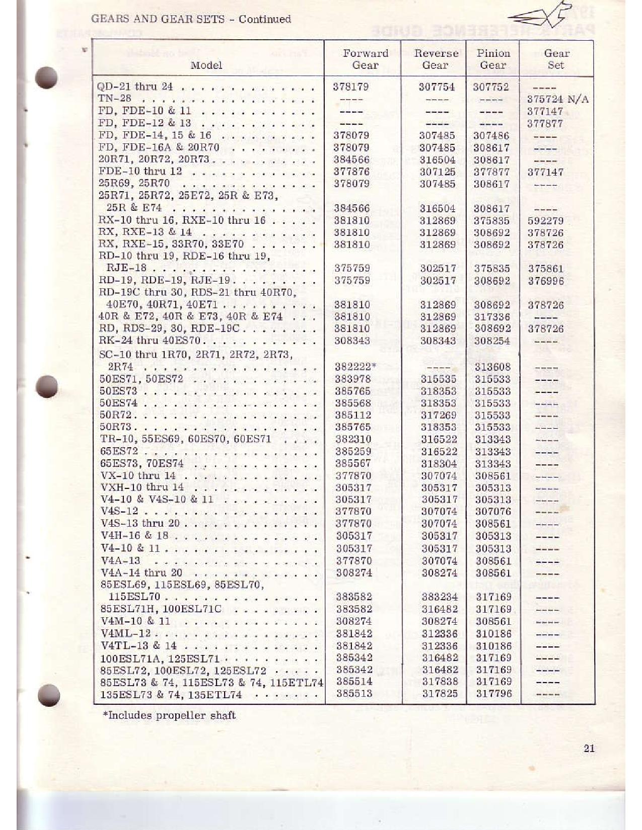

        outboardnut
          Can this be of use?
          From 1974 parts reference guide
          Ind-numbers-prop-gears-1974-Parts-Ref-page-001
          #253736
          boscovius
            Thanks Outboardnut.
            I see there are gear numbers for the RD line in there.  Probably might come in handy.  I need to figure out what the difference is between the Part number for the gear case and the casting number.  Might like to get the original case on here someday, but might be better running the one I have for now.
