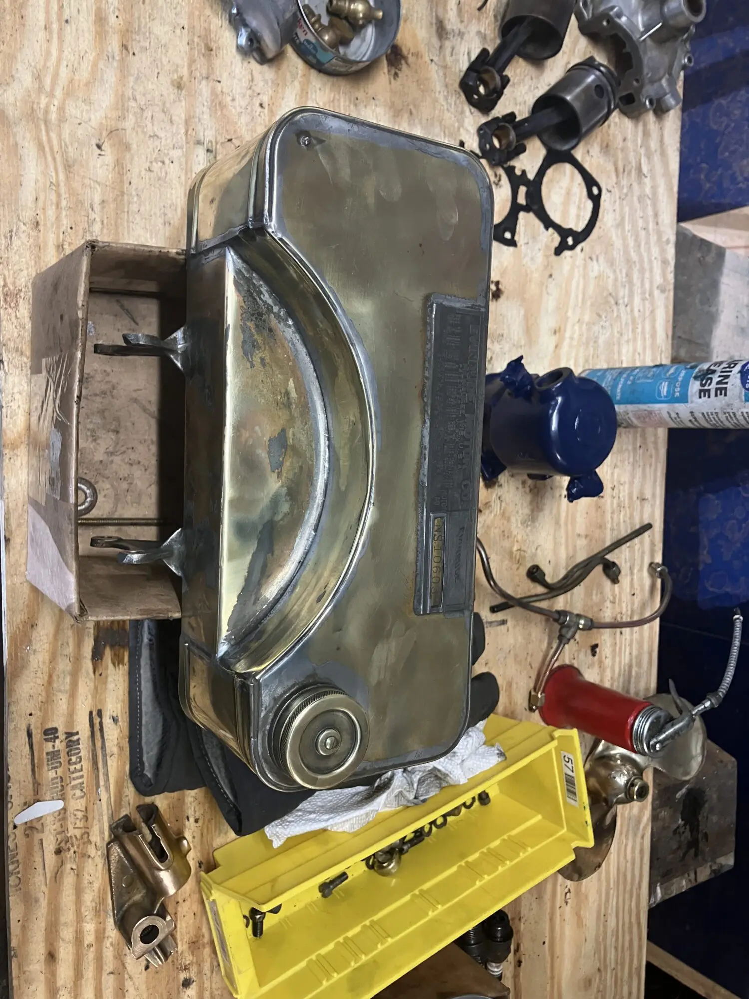

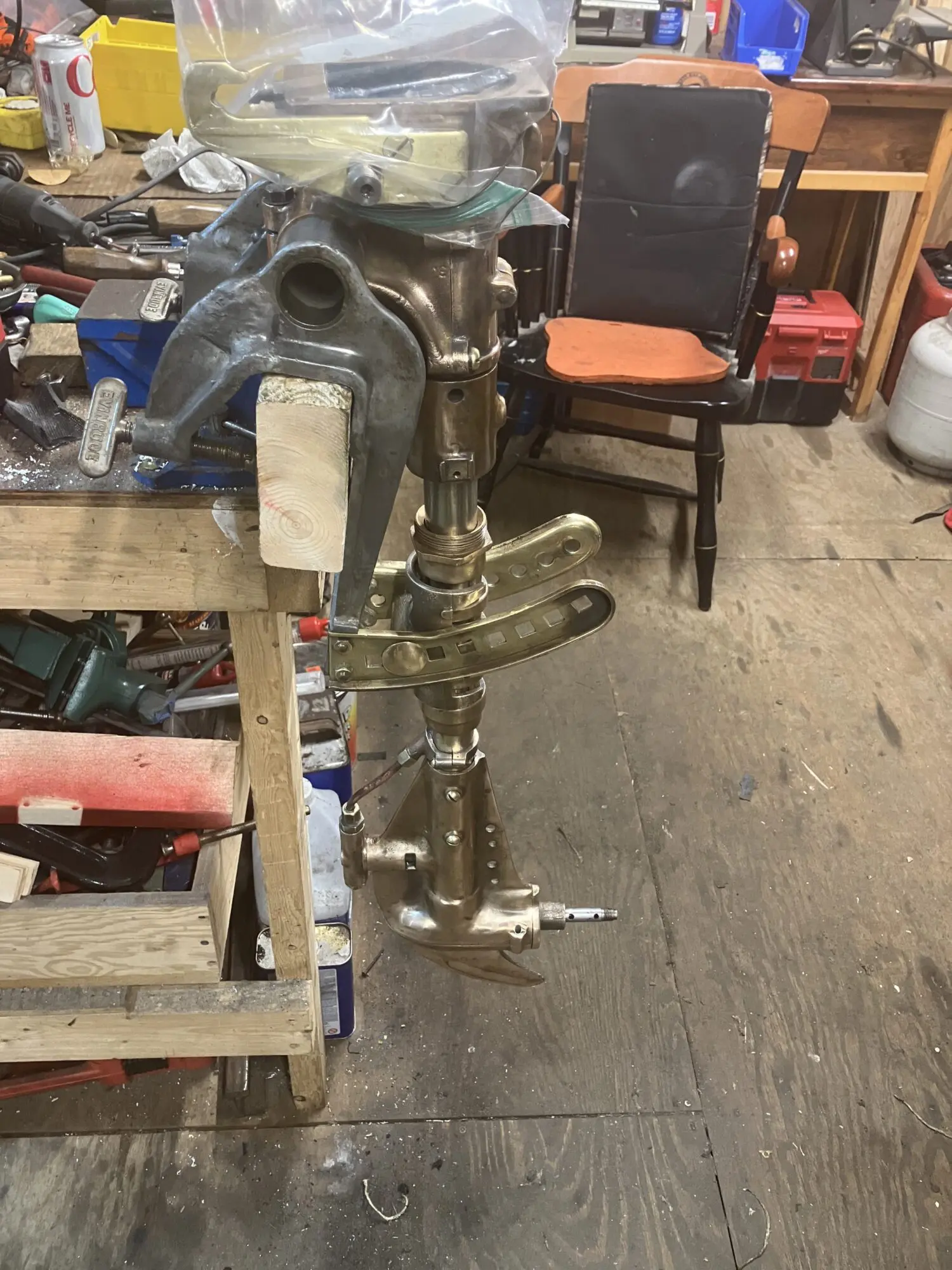

April 6, 2026 at 6:39 pm #314369I got a pair of rings from a member at our Pine Tree Boating meeting on Saturday! Thanks Tom! Did some cleaning and polishing on the bronze/brass items and the tank. I took the reverse linkage all apart and cleaned the swivel tube and repacked it with string covered in grease.

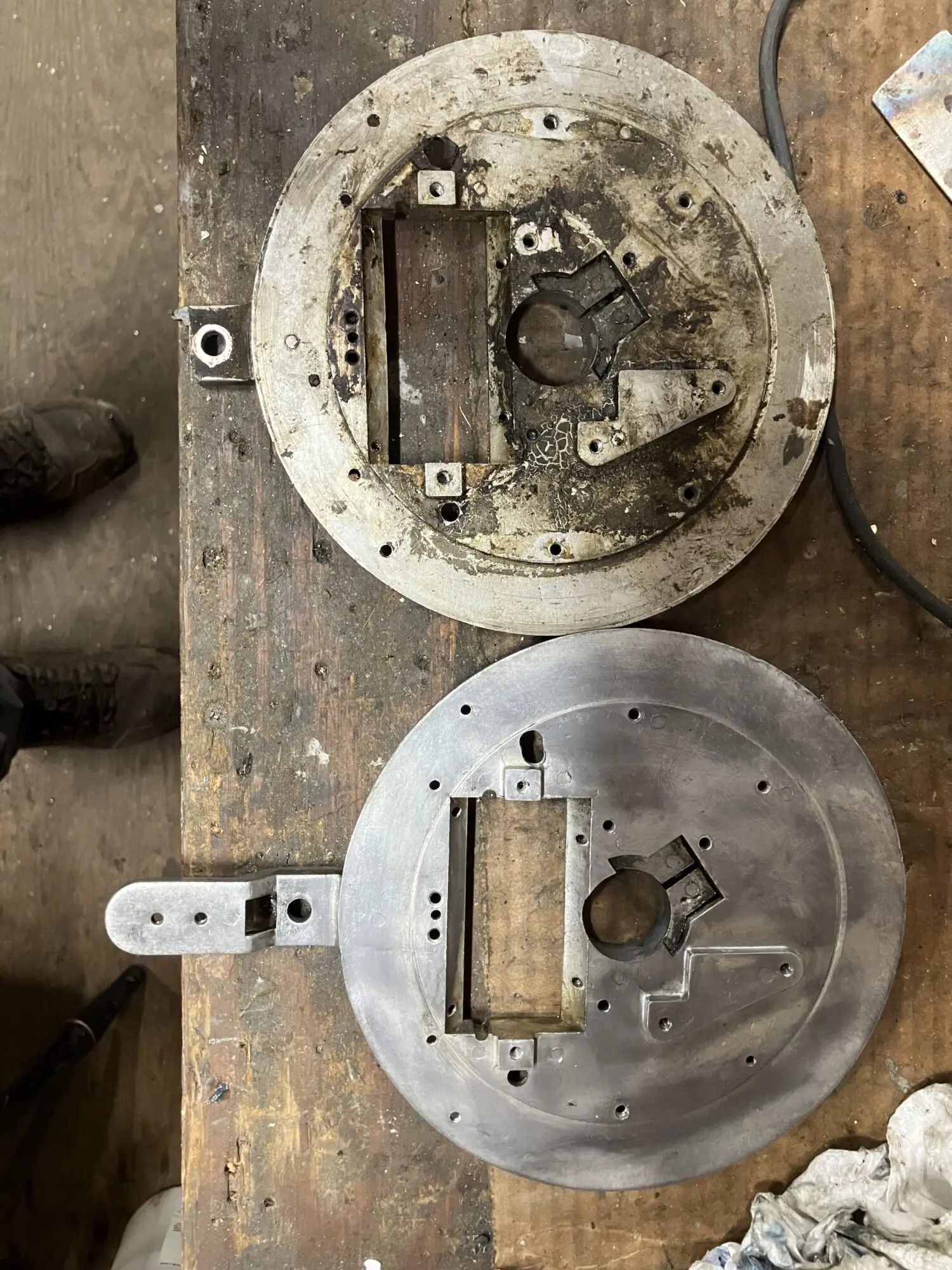

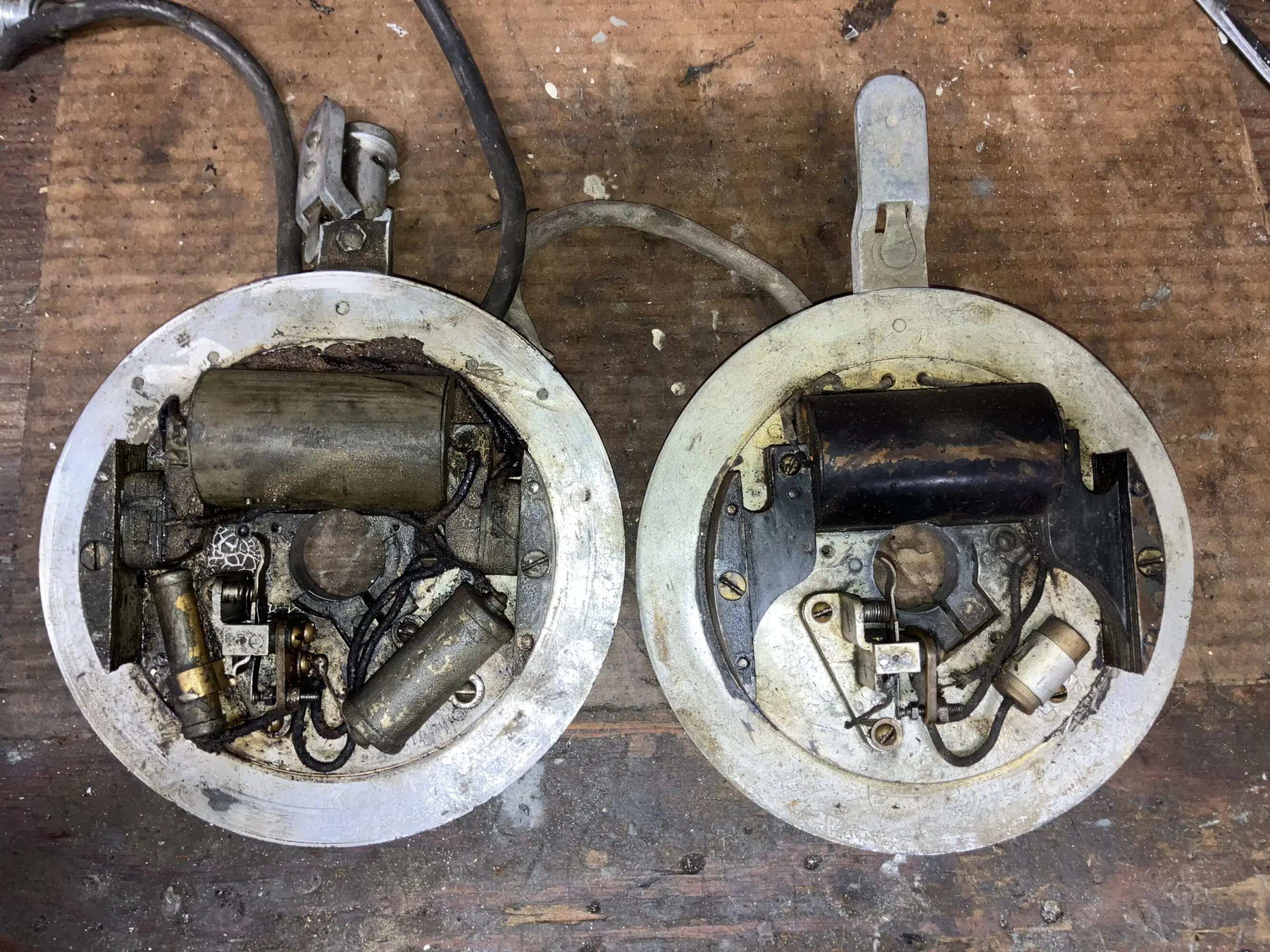

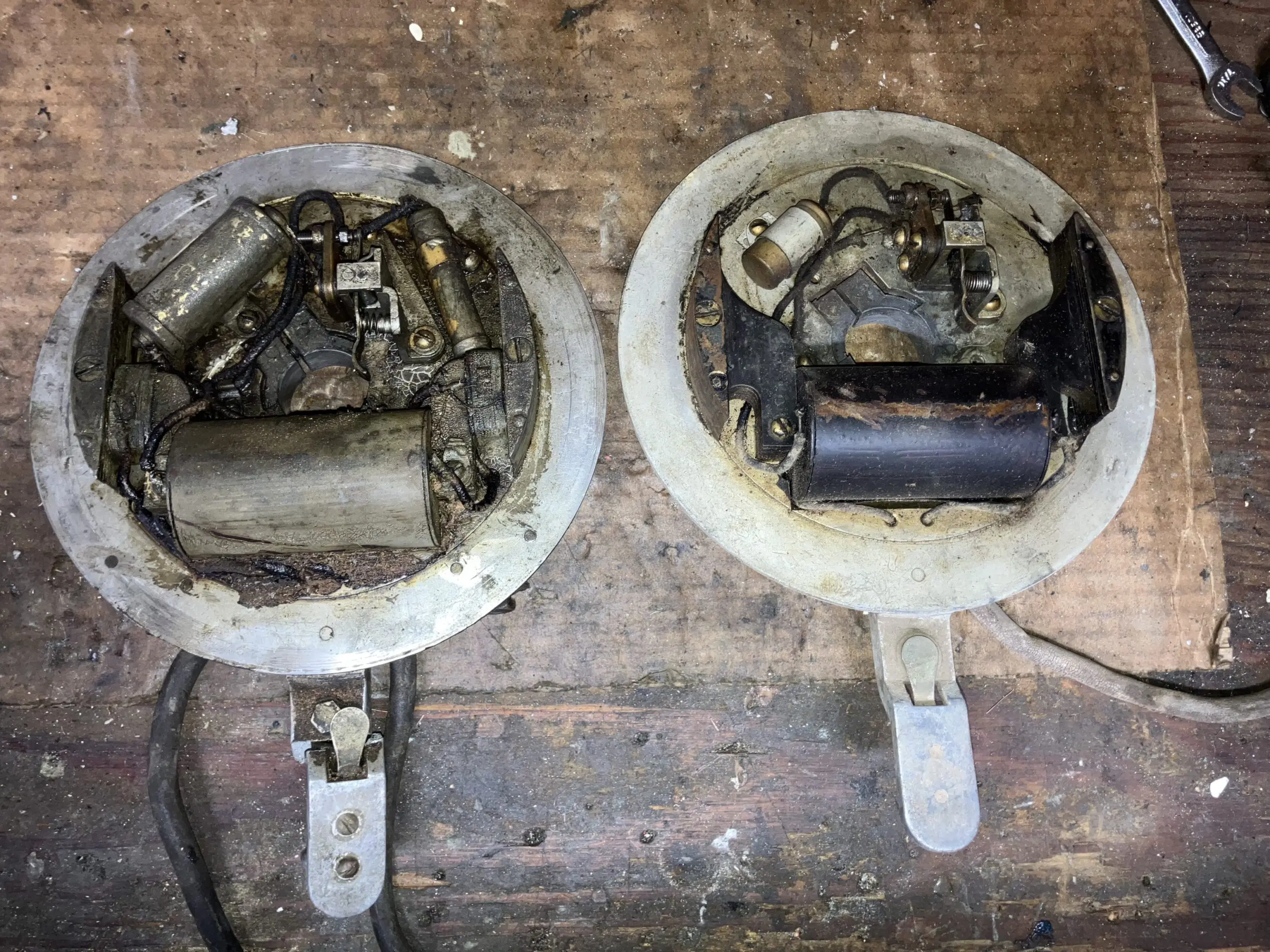

April 7, 2026 at 2:33 pm #314480Today begins the dreaded magneto part of this project. You can see the differences between the “standard” and the “deluxe” versions of the magneto. Some extra goodies involved with the lighting coils. Fun!
I bet you can guess which is which.Does anyone have any suggestions on what to use to clean the components?

April 7, 2026 at 2:39 pm #314483Now I could take the easy way out and just swap in the “standard” magneto after replacing the plug wires and condenser, but what would be the fun in that?
I’m going to attempt to bring the “deluxe” goodies over to the unbroken plate. Lots of extra wires and connections involved, but I have the time and maybe the patience.
I had to drill and tap several extra holes in the unbroken plate to accept all the cool stuff.
The input/output switch thingy’s are pretty interesting.

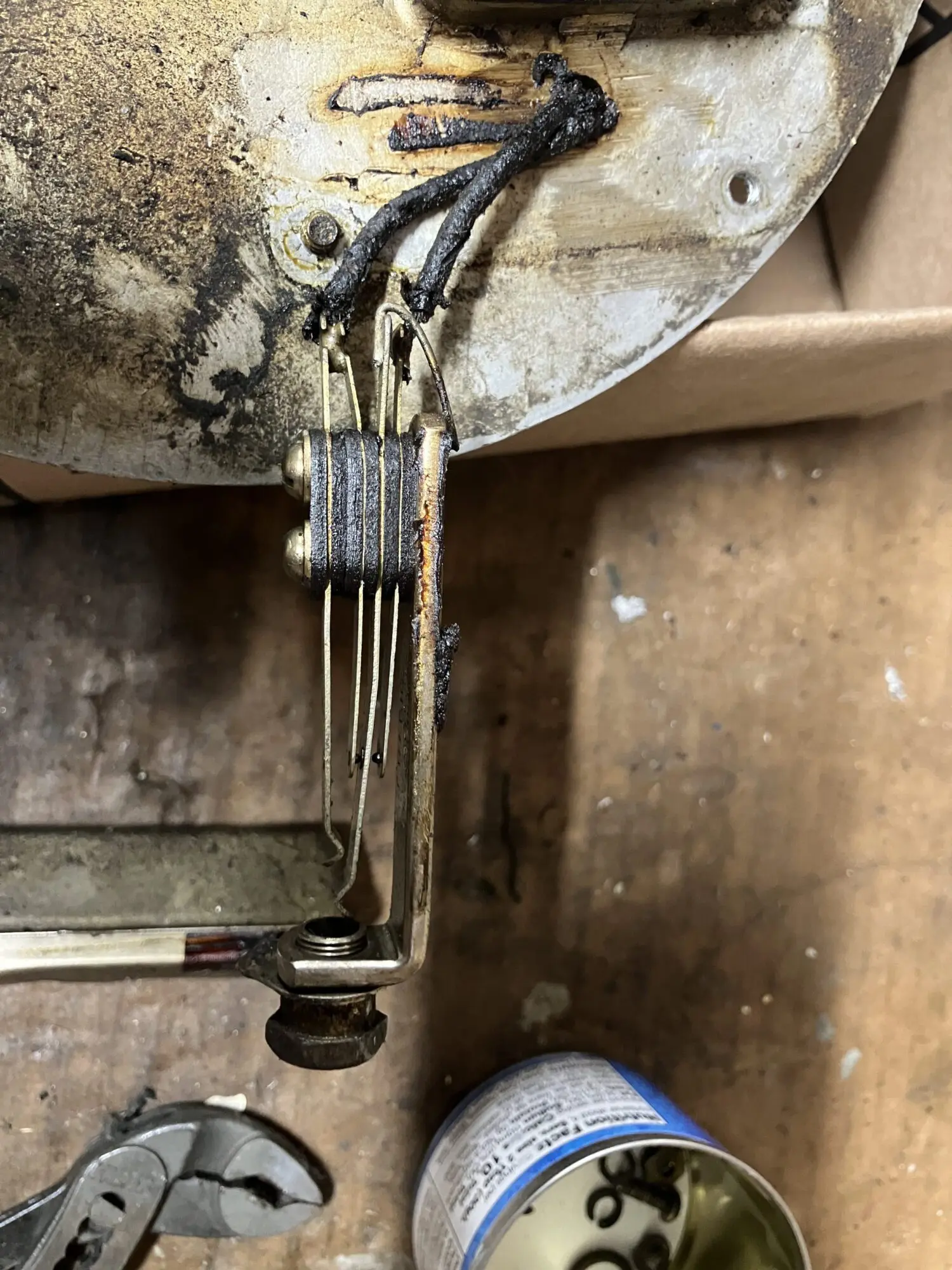

This is the “battery” input The “Light” side has 4 wires involved.David Bartlett
