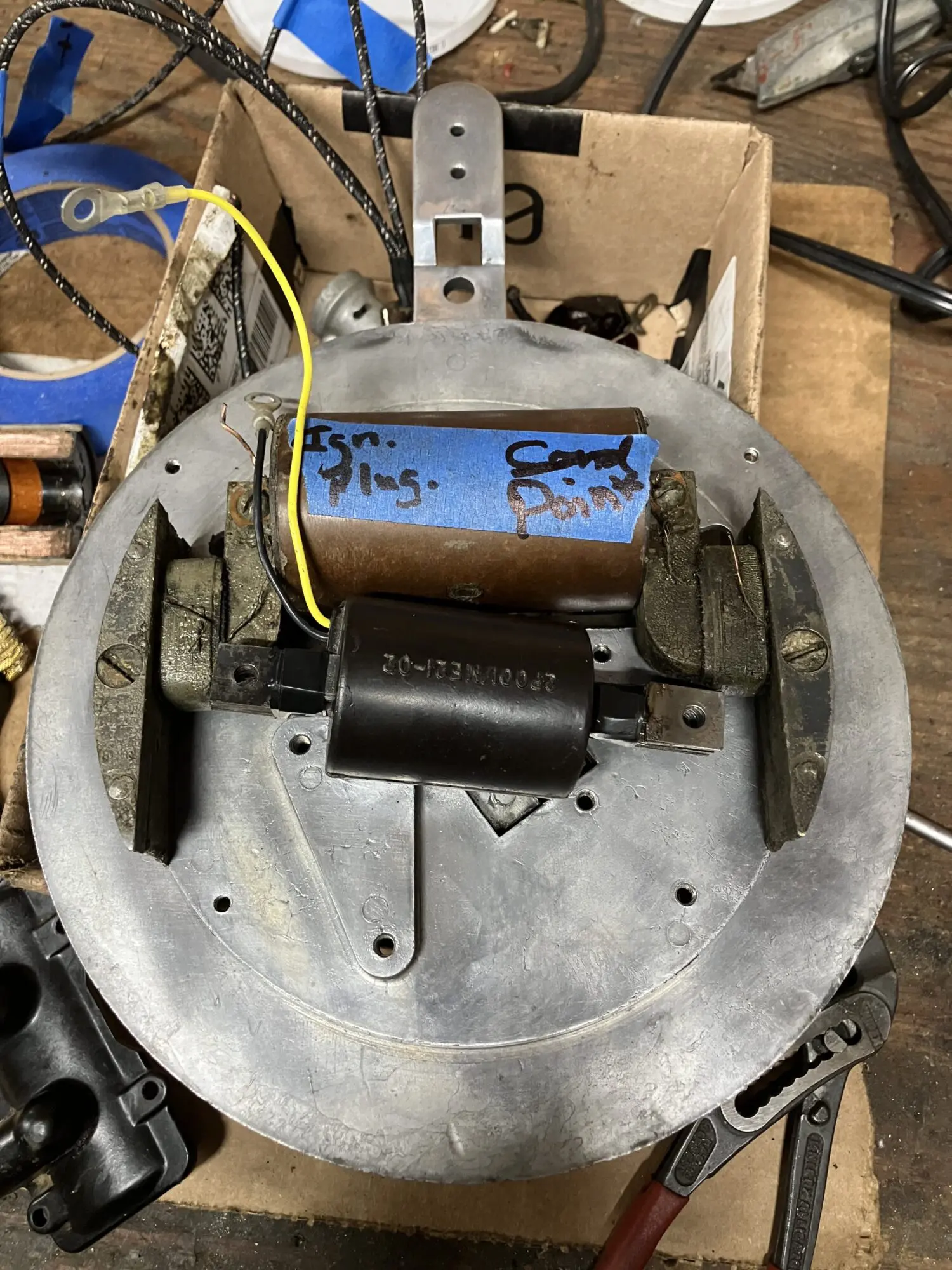

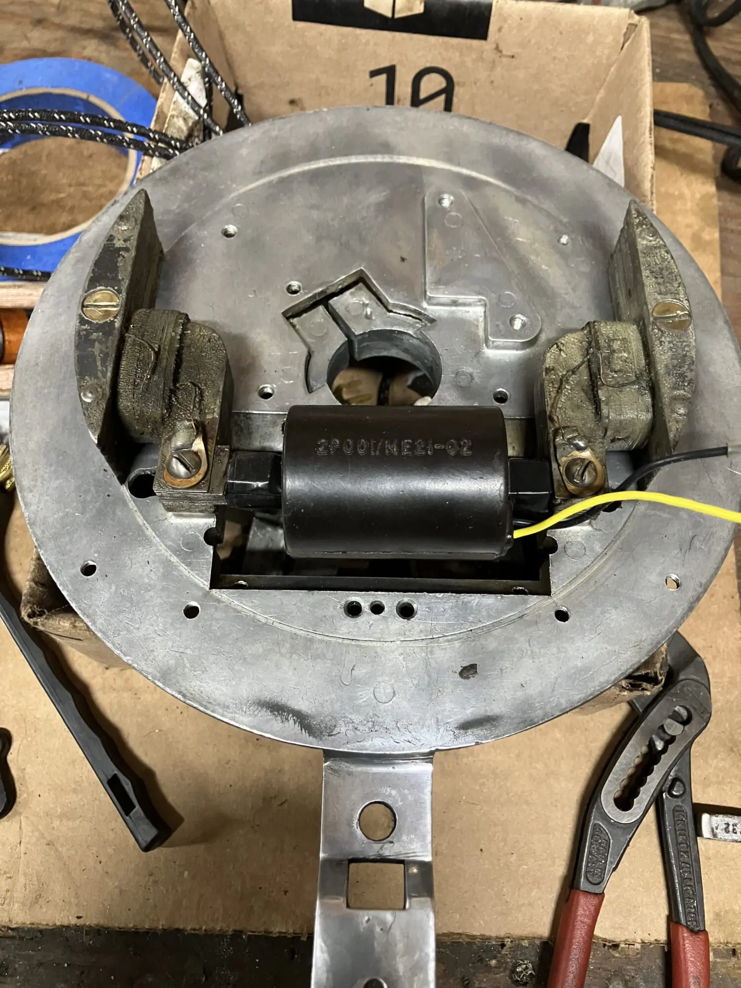

              So the secondary windings are bad in both my Evinrude coils. Disappointed, but not surprised. On to plan B with the military coil option.
              IMG_6926
              IMG_6927
              Not my best work, but as Tubs says, it is “Good enough for who it’s for”!

                It’s a pain to get those laminated out of the Military coils, but
                they save the day.
                Does the lighting coil test okay?
                #315354
                  Nice job on the retro. Looks factory. Did you use the single or two lead coil?
                  #315382
                  David Bartlett
                    I had a 2 lead coil in my pile already. They are cheaper than the single last time I bought any.
