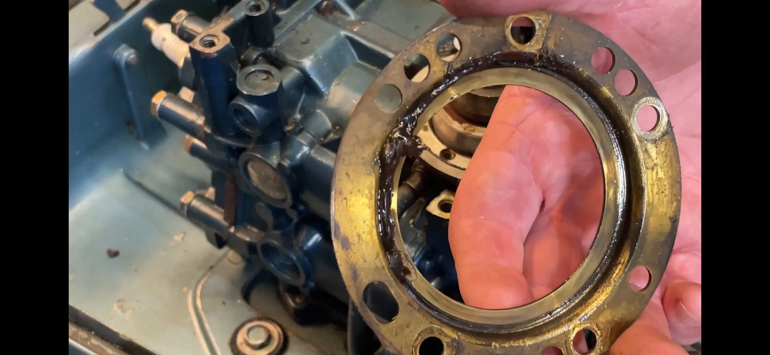

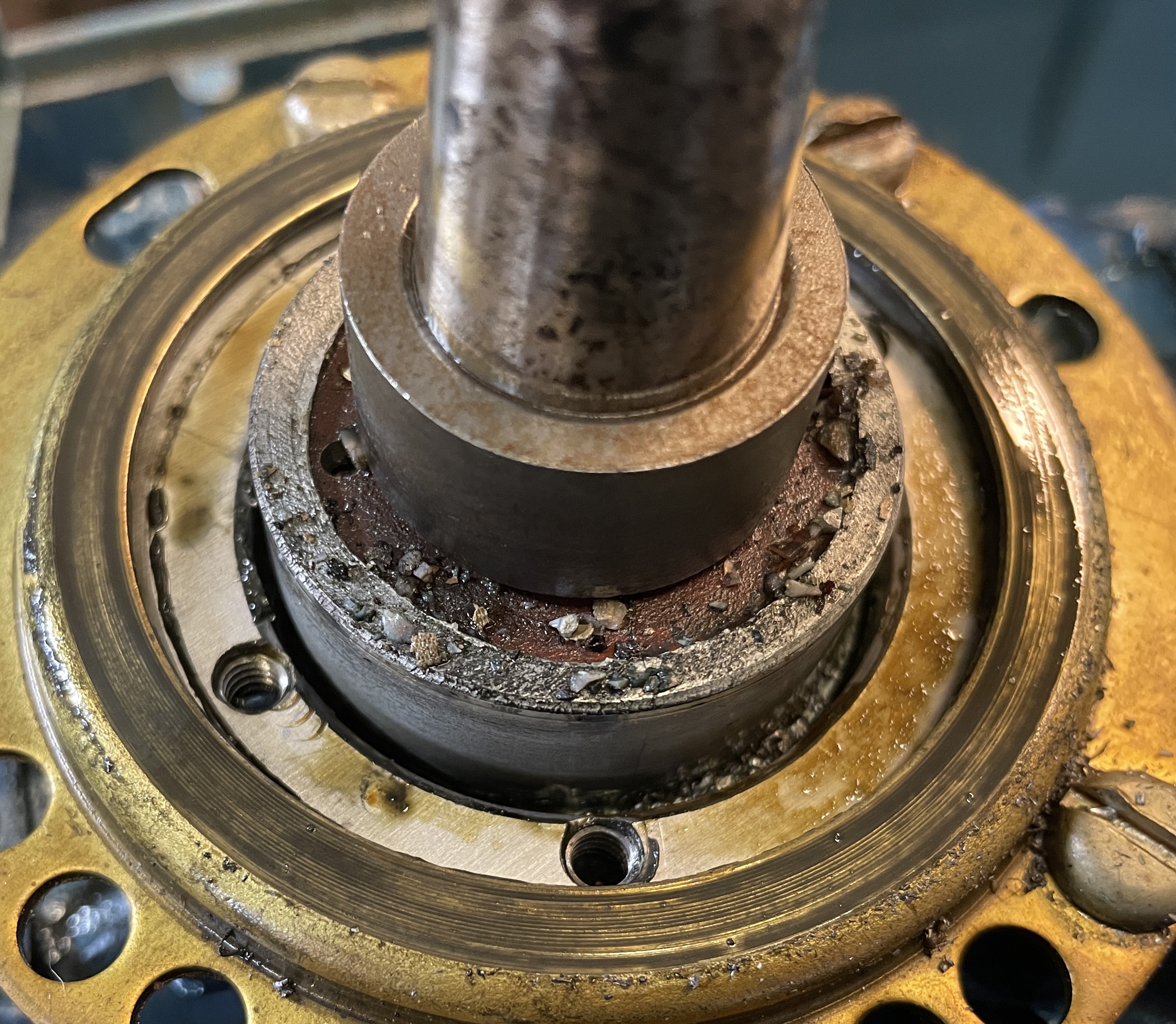

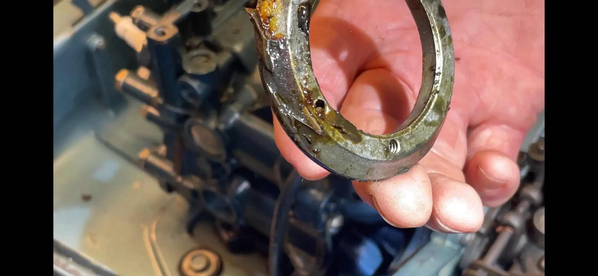

June 1, 2026 at 9:11 pm #320570I have removed the flywheel and the armature plate (if that’s the correct
name) and cleaned up all the grit from the deteriorating coils. It’s almost like someone poured sand in the engine.
I cleaned up old dried grease from these two parts. Is there a particular kind of grease I should use for reinstallation?
Thanks.June 1, 2026 at 9:21 pm #320574June 1, 2026 at 9:45 pm #320577I have always applied a bit of the conventionnal outbord grease (usually blue colored)
btw pics are clear 🙂

June 2, 2026 at 12:15 am #320594I usually line up one “base ring” bolt hole with one mag plate bolt hole using a sishkabob stick.. after the first bolt is in the rest line up easy. Base ring is flat side up taper side down ..I think…. but if you are not certain wait for confirmation by others . oil the cam oiler wick ! I use 2 drops GC oil
…clip is $$$$ ! don’t loose it
June 2, 2026 at 12:24 am #320595the black ring looks like a carbon seal that goees on top of the drive shaft
June 2, 2026 at 11:23 am #320626Here is a breakdown of all those seal parts that go on top of the driveshaft. This is extremely important and can lead to powerhead failure if not installed correctly. The little oring and cork gasket should always be replaced. The large SS washer/cork gasket may be stuck to the bottom of the powerhead…
