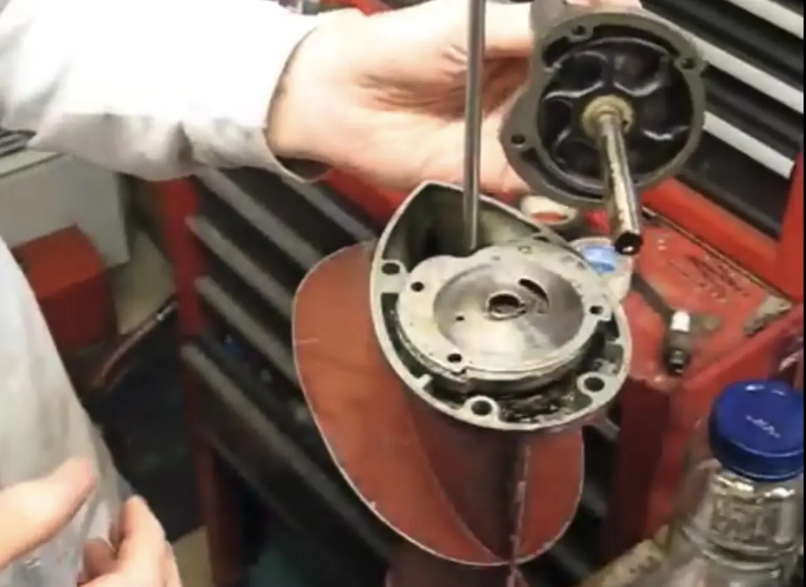

Thank you! I saw that picture in the service manual, but I also saw enough other pictures that I ended up confused.

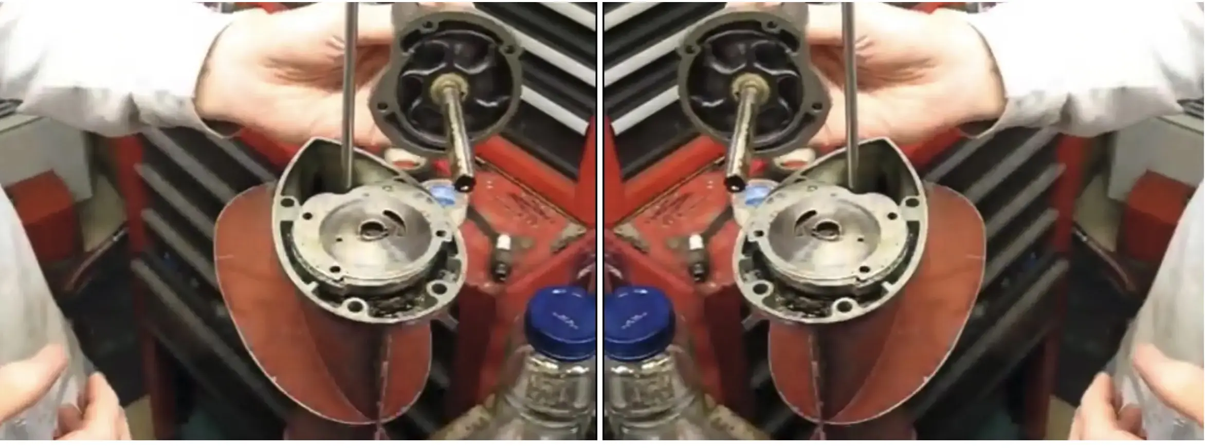

June 15, 2026 at 5:49 pm #322129I’ll try to attach another photo, and see if I end up with someone else’s photo instead. This is supposed to be a screenshot from a video in which the water pump has just been removed. Unless I’m getting my wires crossed, the impeller looks like it’s been turning clockwise, but that’s when viewed from below. So if you viewed it from above, wouldn’t it be turning counterclockwise?
June 15, 2026 at 8:24 pm #322142I’ll try to attach another photo, and see if I end up with someone else’s photo instead. This is supposed to be a screenshot from a video in which the water pump has just been removed. Unless I’m getting my wires crossed, the impeller looks like it’s been turning clockwise, but that’s when viewed from below. So if you viewed it from above, wouldn’t it be turning counterclockwise?

June 15, 2026 at 9:14 pm #322150the impeller always turns clockwise looking down on it because the drive shaft turns clockwise
June 15, 2026 at 9:31 pm #322153I’ll try to attach another photo, and see if I end up with someone else’s photo instead. This is supposed to be a screenshot from a video in which the water pump has just been removed. Unless I’m getting my wires crossed, the impeller looks like it’s been turning clockwise, but that’s when viewed from below. So if you viewed it from above, wouldn’t it be turning counterclockwise?

June 15, 2026 at 9:33 pm #322154the impeller always turns clockwise looking down on it because the drive shaft turns clockwise
Got it. Thank you for that clarification!
June 15, 2026 at 11:01 pm #322161OK, well first, something about that SS impeller plate does not look right to me. There are two types of OEM water pumps for this engine. One has a plastic housing and a smaller impeller. The older style uses an aluminum housing and a larger impeller. None of the part are interchangable, including the SS impeller plate.
Looking down onto that impeller, it spins clockwise. Is that a used impeller, the blades look like they have taken a set. If so, that impeller is on upside down, the blades are facing in the wrong direction. The picture in Jaques’ diagram has the impeller blades facting in the correction orientation…
Again, post pictures of the impeller housing, something is wrong with that SS plate.
Didn’t see seakay’s picture, that is the correct orientation of the impeller blades
June 16, 2026 at 8:50 am #322186June 16, 2026 at 9:47 pm #322249OK, now even I am confused…. What the heck picture of Seakay’s was I looking that was right…. But again, let’s start with that impeller plate that appears to be the wrong one… Anyone else seeing this???
The big picture from the manual is correct, for now I guess…
