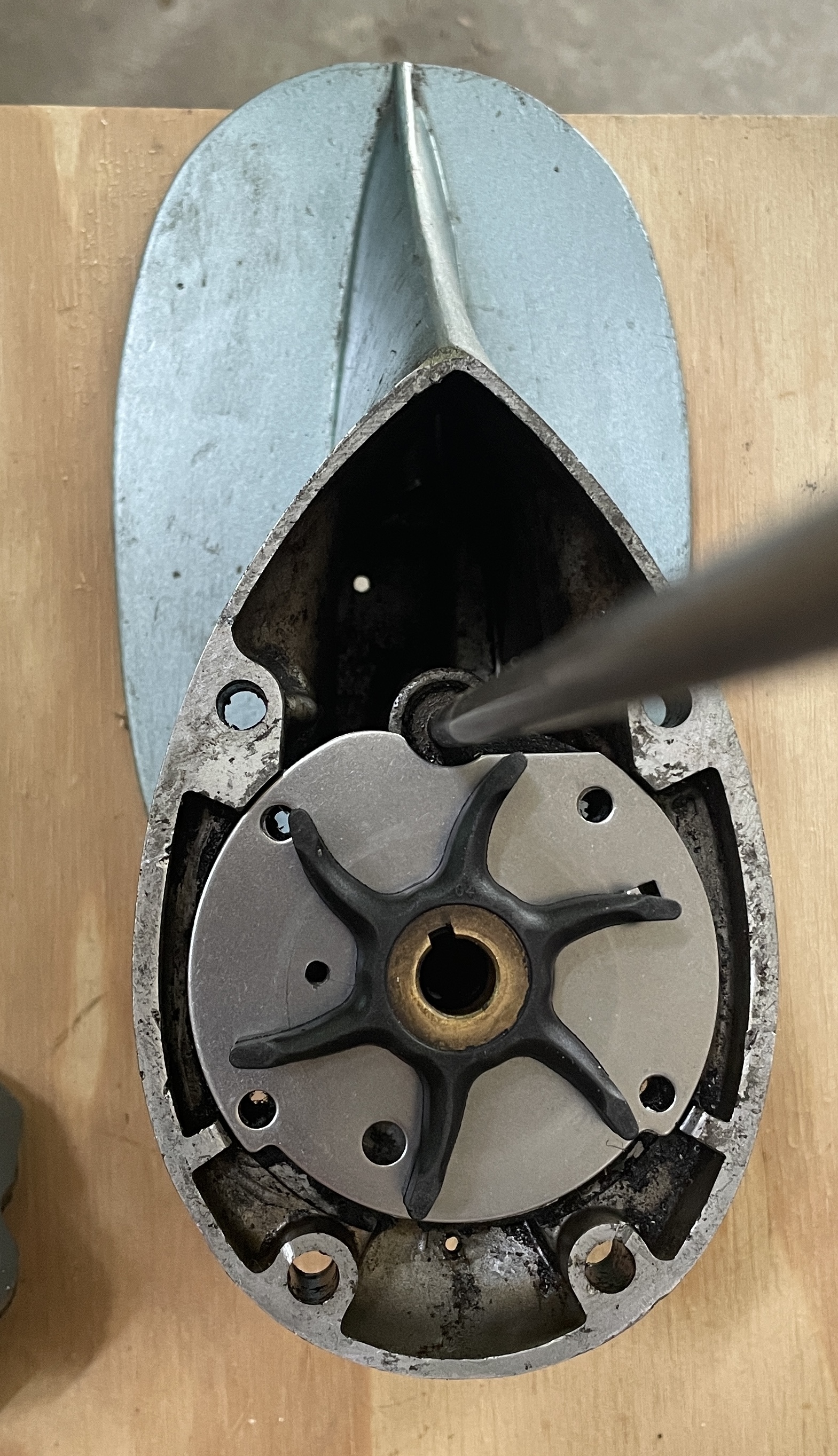

June 15, 2026 at 2:48 pm #322110I’m preparing to install a new impeller, and I can’t remember the orientation of the old one when I took it out. I’m thinking it should be installed as if it were spinning counterclockwise when looking down on it, which would be clockwise when looking up into the water pump housing. Is this correct?
June 15, 2026 at 2:51 pm #322112June 15, 2026 at 2:54 pm #322115OK, I give up trying to post photographs, but can anyone answer the question? Thank you.
