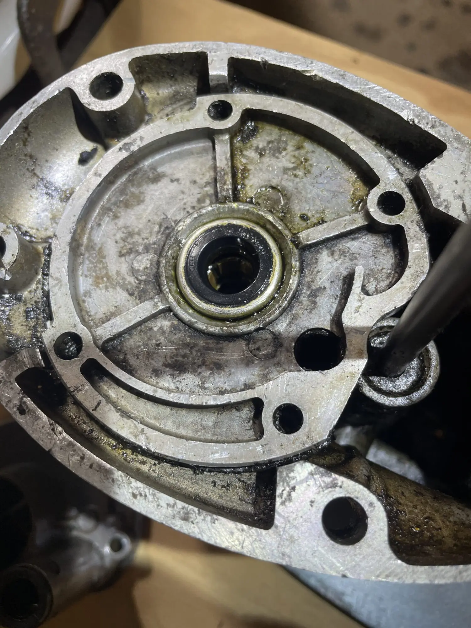

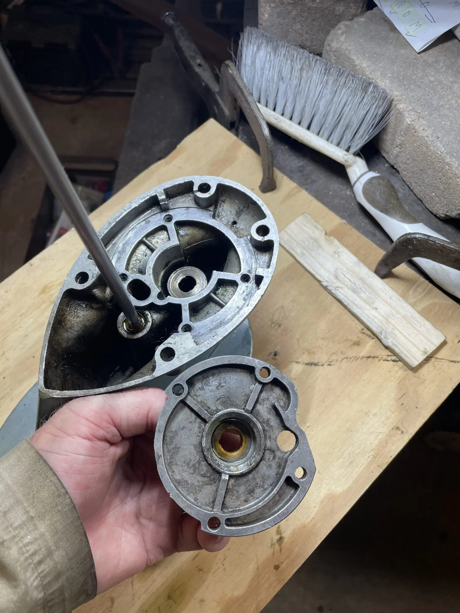

Perhaps I should start a new thread, but I have some questions regarding the gear case.
I’d like to replace the oil seal beneath the impeller, but I am not sure how to go about it. The driveshaft housing that contains the seal moves a little bit, but I am hesitant to pry too hard on it in case there’s something else holding it down. If I could remove the driveshaft housing, then I could press out the oil seal and replace the gasket under the housing as well.June 22, 2026 at 10:37 pm #322743pullers exist but carefull work with a dremel tool ( while not damaging the seating surface) will weaken the seal and allow it to b pried out. warning up the perimiter with a heat gun could also allow easier pull out.
June 22, 2026 at 11:42 pm #322748Sounds good. How do I remove the driveshaft housing so I can replace the gasket underneath it?
June 23, 2026 at 9:02 am #322765??? seems like the drive shaft is out in you picture no ?? in any event that base plate over the lower GC cavity can be lifed out and the seal “attacked” from the other side. When all done install a new gasket and rebuild the pump. while doing all this check the spring clutch (shock absorber) underneat and make certain it is not streched! max lenght was 6”11/16 if I recall correctly but check.

June 23, 2026 at 5:51 pm #322806Got the oil seal out.

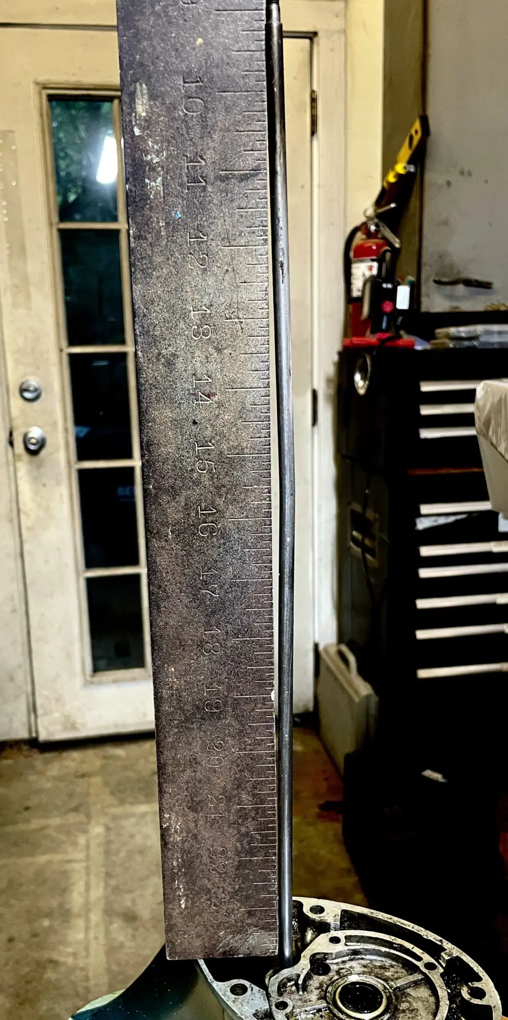

More questions! As you can see in the attached photo, the shift rod is bent. It’s supposed to be straight, isn’t it? It certainly appears straight in diagrams. Also, when I turn the driveshaft clockwise, the propeller spins counterclockwise (when viewed from behind) which to me indicates that it’s in reverse. Should I be able to move the shift rod up and down by hand while the lower unit is separate from the rest of the motor? It is absolutely tight and unmovable.June 23, 2026 at 9:12 pm #322820i doubt the bend will be a nuisance hard to say if it is design intent unless sombody can clarify. you should be able to shift fw… if you try harder check shifter handle if it pulls up or pushes down for FW.
June 24, 2026 at 9:40 am #322854Got the oil seal out.
More questions! As you can see in the attached photo, the shift rod is bent. It’s supposed to be straight, isn’t it? It certainly appears straight in diagrams. Also, when I turn the driveshaft clockwise, the propeller spins counterclockwise (when viewed from behind) which to me indicates that it’s in reverse. Should I be able to move the shift rod up and down by hand while the lower unit is separate from the rest of the motor? It is absolutely tight and unmovable.Nice work getting that seal out, this can be a very difficult, yet delicate job indeed! Look at the bottom of the upper seal housing, make sure the lower driveshaft has not been rubbing/grinding on it. If it had, you may need to do something with that darn spring clutch which may have expanded. I wouldn’t worry much about the slightly bent shift rod as long as it is not distorted/bent where it rides through the shift rod bushing/oring inside the gearcase.
